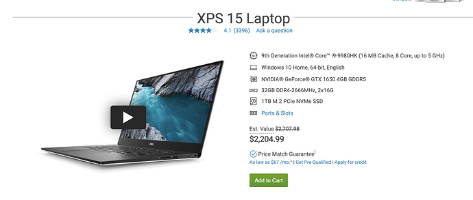

I’m thinking that might be the case, and if so I was looking at this:
This has an NVidia GTX 1650 card which seems to be suited for SketchUp and other 3D stuff…

What do you think abou that XPS 15 inch though?
I would think with the i9 and that graphics card this would be a pretty competent machine.
I rather agree. It ought to be somewhat faster than my current work computer, the graphics card scores a tad faster than the Quadro P2000 in mine, and mine has an i7 CPU.
