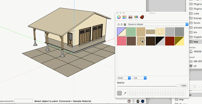

I can now see how to change the default face colour deliberately. But I still can’t work out how it got changed globally by accident. It happened to both me and Scott yesterday or the day before and there is no parent component to be changed accidentally that would have this global effect.
I found it happened to me while I was using the Colour palette ‘In Model’ colours, as I described above - clicking on a colour changed the default, not the paint bucket colour.

To change it deliberately, go to Styles/Face style, and change the Front colour, and save the result.
On Mac, it looks like this:
Click on the swatch beside Front, then pick the default front face colour you want.

I think I’ve now worked out what happened, and also why I got confused.
Try this:
Select any face in a component open for editing.
Open the Styles/Edit/Faces/Front colour and click on the swatch beside it. That opens the Color window on Mac.
Choose any In Model colour. Click it. The default swatch goes half that colour, and all the default colour faces go that colour.
Not unreasonable.
Click the default swatch in the In Model colour palette. It goes white again.
Click any colour again. The default swatch goes that colour. And so does the default Front face colour if the Styles window is still open for editing.
I think that must have been what happened to me - I had** had** the Styles window open for edit, and left it that way without noticing.
Click anywhere in model window. That seems to ‘lock’ the Front face colour.
So, sort-of explains how it happened to me.
Logical, in retrospect, but not expected and very puzzling at the time.
