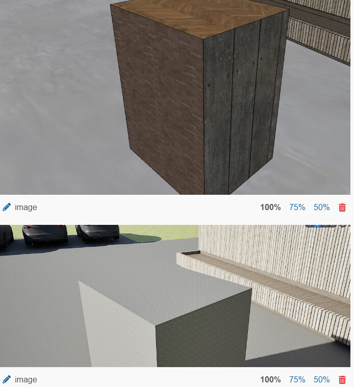

I have a problem after installing Sketchup 2025 with exporting files to datasmith. After importing to Unreal Engine, UVs data does not transfer and I cannot change the texture scale. Regardless of the texture scale in SU, it is the same in Unreal.
Here is view from sketchup and ureal engine. After assigning texture in UE to diffrent textures from sketchup the scale is the same. about 100 times smaller than it should be. It is probably a problem with UVs export to datasmith.

Hi, thank you. Yes I’m using SU 2025 last release. But I downloaded DataSmith latest releas as well. You might be wright about the changes in SU material tray. It seams that Datasmith doesn’t export UVs at all.

Edit: did you apply the materials on the groups OR on the faces itself? And does the material have a texture applied or is it just a color?
I do remember an issue very long ago where if you didn’t assign a texture, you would get very small uvs. Also applying the material on the faces itself should get the best results.
