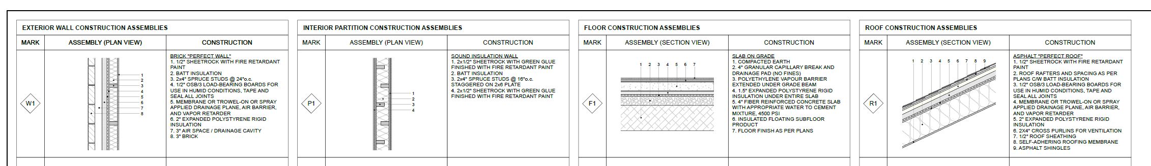

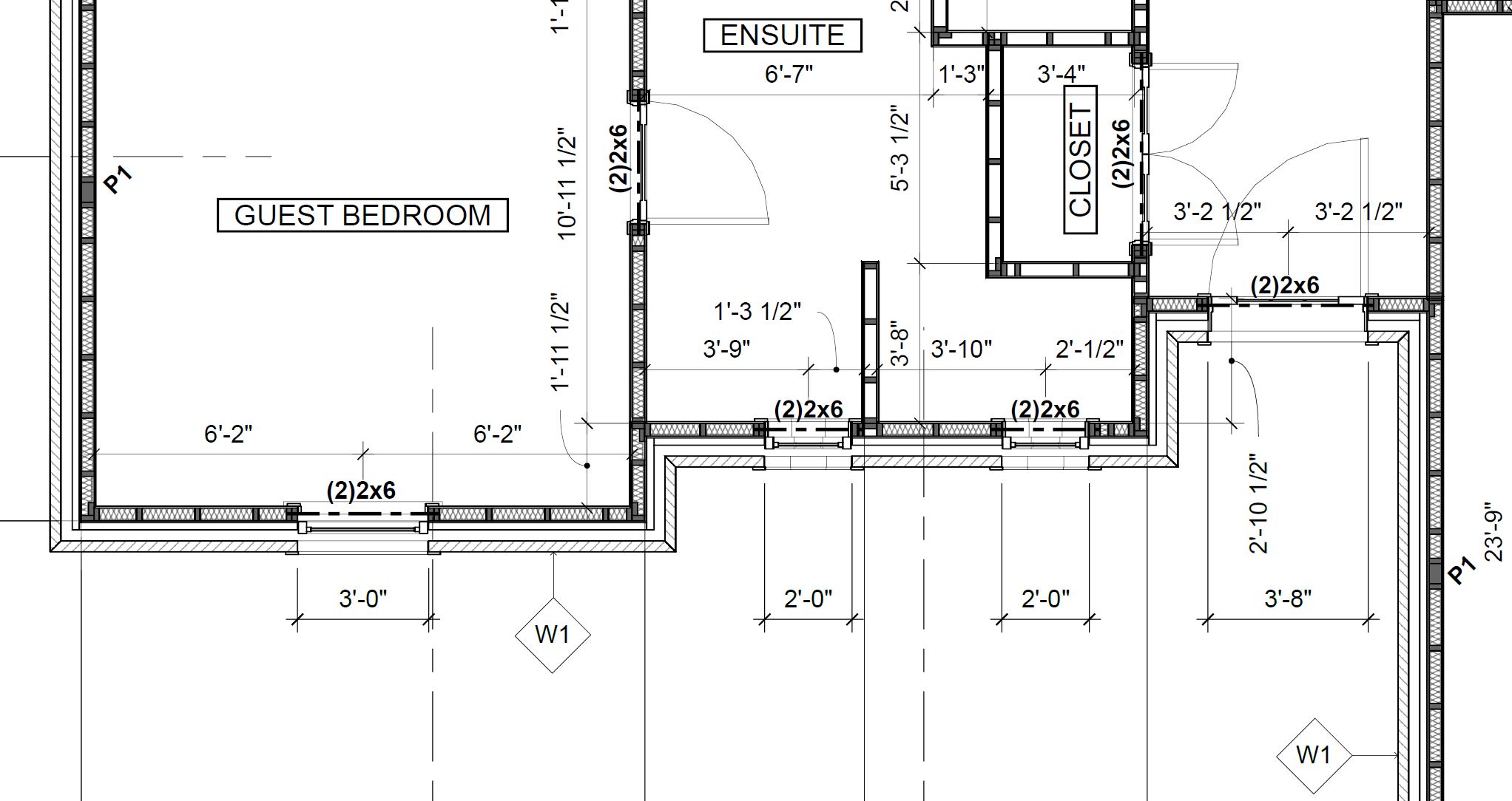

After working with Skalp Section for a couple months, I’ve finally figured out the proper workflow to get it working for me with as few issues as possible. There just seems to be a procedure I have to run through each time to make sure the sections get updated properly when I change the geometry and when I need to update multiple scenes. Here are a couple screenshots from some of my 2D documentation sets using Sketchup + Skalp + @medeek’s plugins + Layout:
It’s a great workflow until I decide to switch over to Archicad!
