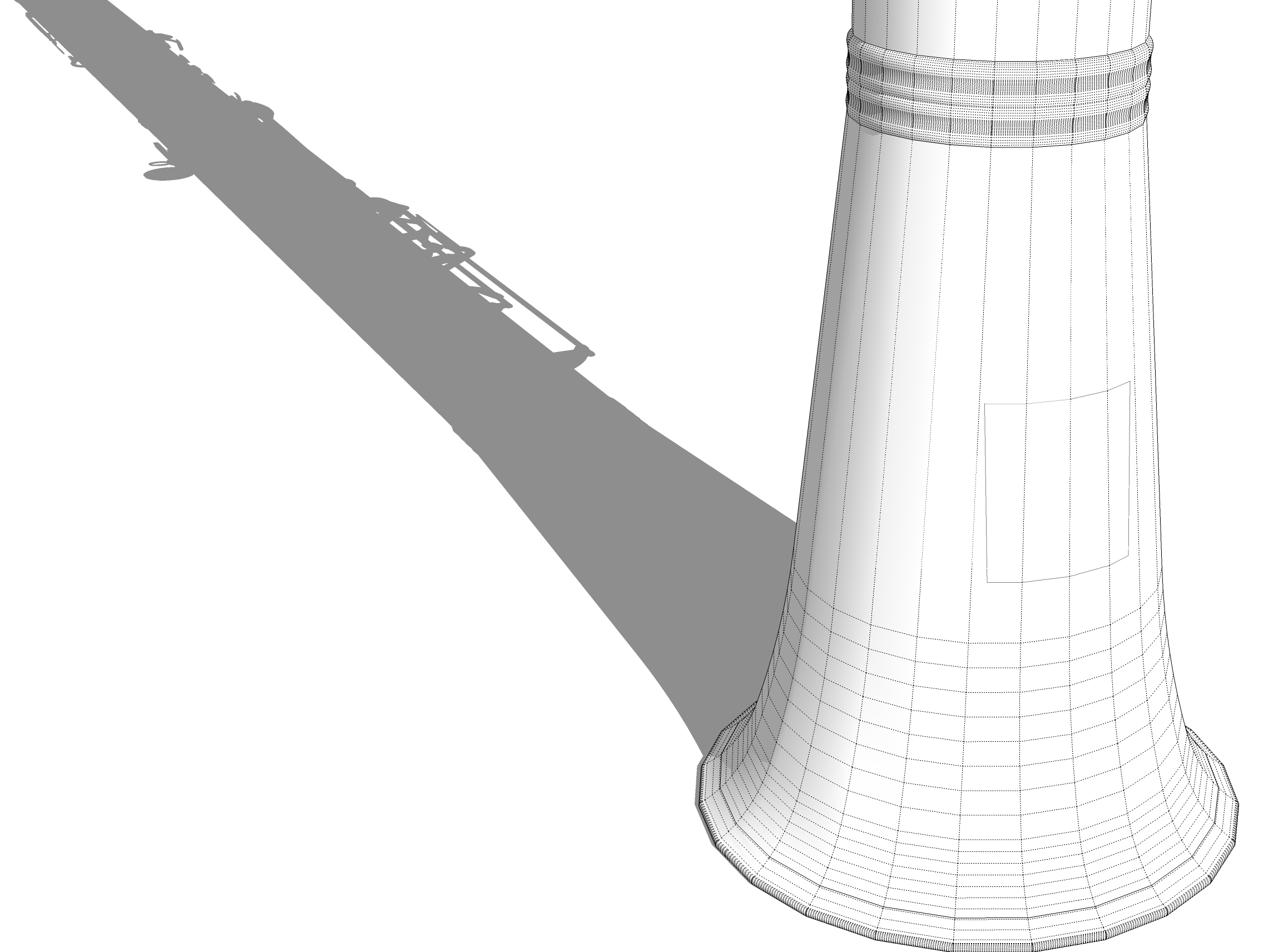

I found a clarinet model in the Warehouse. It has a label on it that was apparently drawn on. Probably the author traced the label. I found a graphic of the label in a Google search and used it to create a material with gold letters on a black background.
To prevent the material from repeating across the bell, I first projected a rectangle the same size as the label onto the bell. This divided the surface into two regions. Then the material is applied to the inner region.
