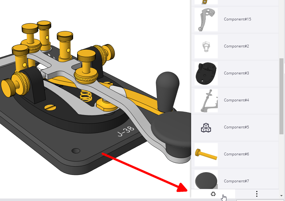

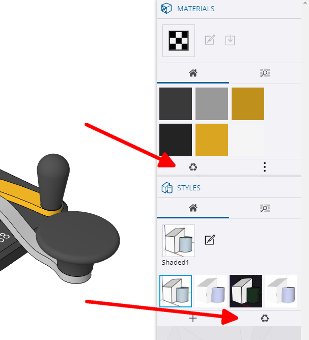

BTW, you might want to see about purging unused stuff from your file. Go to the Components panel and click on the Purge button. Then do it for Materials and Styles.
