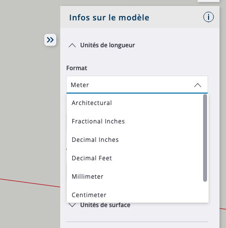

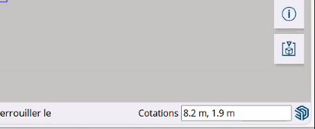

Dear america, most of us use a decimal comma and a semicolon separator in sketchup.
Except in sketchup for web, where it is - since 2019 at least - not the case.
This year I’ve been training more and more people first on the web/go version then later on pro. and it’s a real PITA to have to teach them a rectangle is typed 10.3,2.5 but “oh wait no, now you’re using the grown-up version, it’s 10,3;2,5”
(earlier today, my french student on a french PC using french interface yet still… US notation)
please make it so it uses the system’s choice. or the browser’s choice. or a language-based choice. or even just… give us the option to pick our system, the way we pick our language and input device.

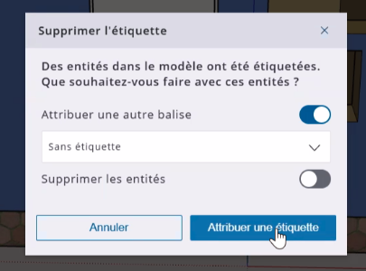

Also, since I have your attention, this year Tags were renamed from Balises to Etiquettes.
on the pro version there is ONE place where they forgot to translate, it’s fine, it’ll wait for 26.
on the web version, there are a couple more cases :

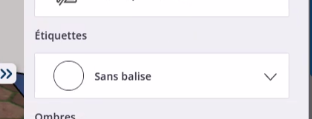

entity info, if you select a group, it seems the default tag still has the old name sans balise instead of sans étiquette
upon deleting a tag, it’s actually the opposite situation : the default tag is properly named but just above, it says attribuer une autre balise instead of attribuer une autre étiquette

Merci, Pierre. I made a bug to investigate making the change.
