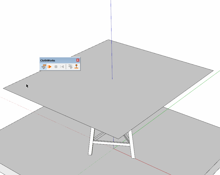

This is what I’m getting in SU 2022. There’s nothing wrong with the current version of Clothworks or SketchUp 2022. It must be something in your set up. Some videos out there showing it have been compressed to make it look like it’s running faster.
cloth
Maybe thats it. How many frames were you getting on this? And how many subdivisions did you use?

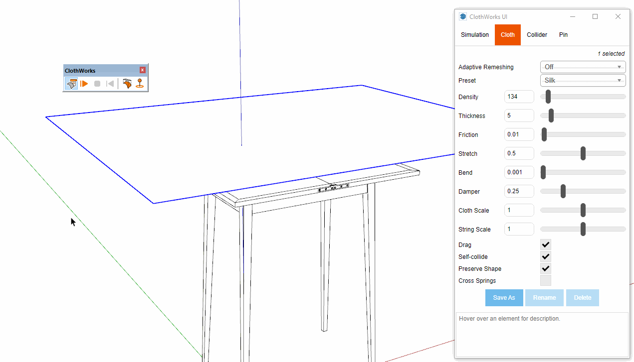

In my previous example the Rate was set to 4 and Multi-threaded was Off. Here I’ve made some changes. Increasing the value for Rate reduces the number of renders. That should help your performance.
Cloth1
Changing the Timestep to something closer to 1/120 would help, too.
Cloth2
It helps a little bit, but not enough to where it’s efficient. There has to be something setup wrong for my CPU, because despite all my attempts it remains too laggy.
