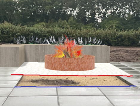

The eye height seems to be ok, and follows where I point the iPad.
On the attached image I kneel down, and can look under the model. The edge, marked with read, should align with the blue edge, but I can’t move the model up or down.
Thanks for the update Kasper. Is the bottom of the firepit in line with the ground plane in your SketchUp model, or is it also floating up off the ground a bit in SketchUp?
The trick is to make sure that when you activate the Scene while in AR, your iPad’s camera is located at approximately the same height above the base of the firepit, to match the relative camera height in the scene that you created in the SketchUp model.
For example, if the firepit is at ground level in your SketchUp model, and if, when holding your iPad out in front of you, you approximate that the camera is level with your eye height (say, 5’ - 4"), then you could activate either the Look Around tool, or Walk tool in SketchUp and use the Measurements box to set the SketchUp camera to 5’4". After that, make sure to update your scene and that should do the trick.
