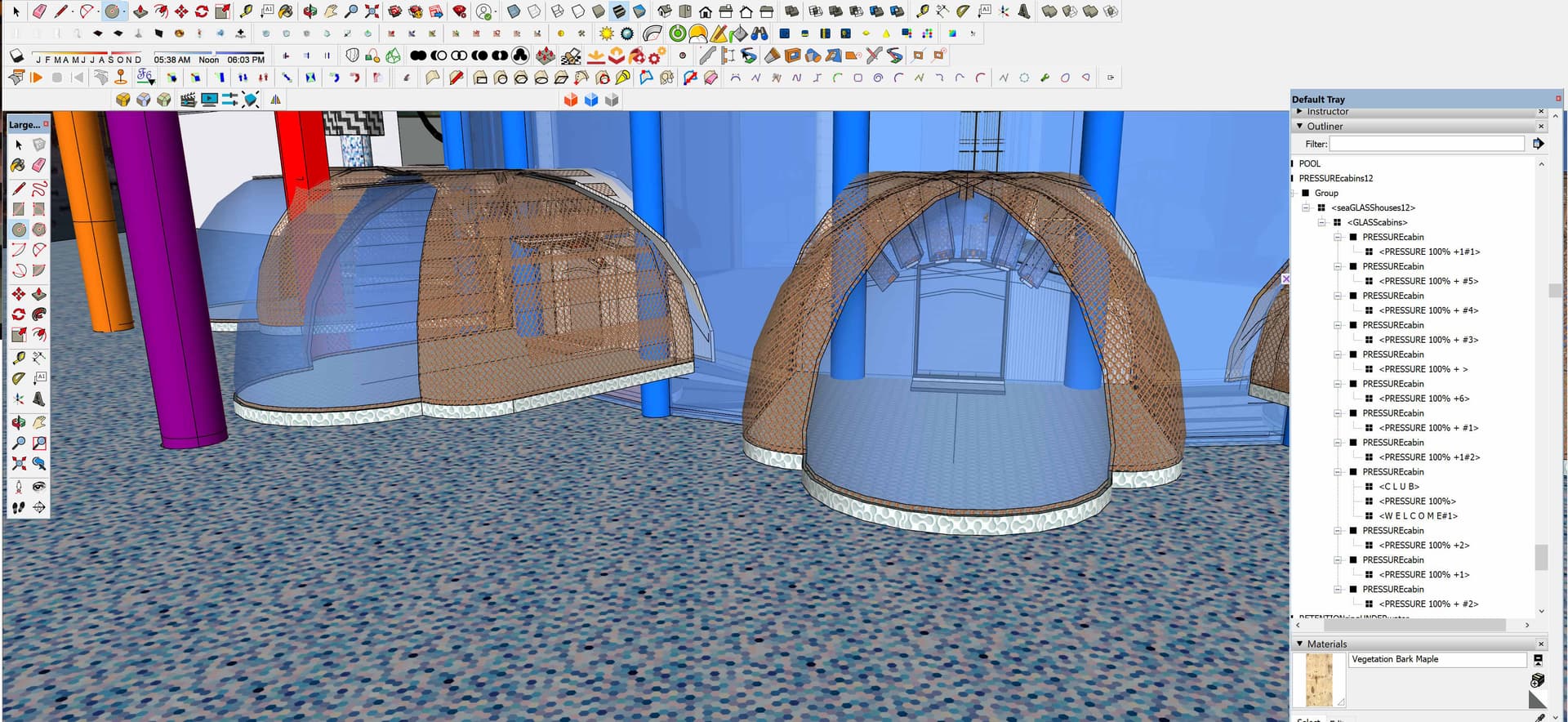

I have twelve glass and mesh cabins they are the same
I copy pasted them in a circle and made them into one group
Now I’d like to change all of them like components
each hut is a group
all twelve huts are one group
I can’t to seem to make them all into components.
Must I delete them all make the first one a components then assign their position again
which will be time consuming?
I would like to change one and then all will change (or if I want one to be unique)
Thank you

I don’t know I can’t tell. Sorry
I right clicked on my cabins and they all have these numbers?
They are numbered inside over the door from 1 to 12
They are around a circle but at every second face

Look in the “Entity Info”, not the Outliner.

In the entity box
it only gives the name of the group and says 1 in the model :frowning:
I have marked all the position of each with three vertices (center front and side angle where the glass curves meet)
Tomorrow will delete and try to create around the center point. My model is 1.4GB I can’t upload it at all. It is late here now.
