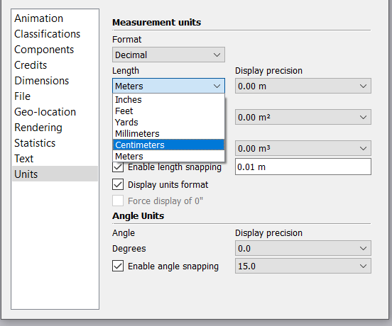

centimeters
Windows - Model info - Units
in sketchup 2023 PC, the non english versions, there has been a gremlin messing up the units a bit :
In french, Yard has been renamed Metres by accident. so there are two metres in the menu, and one of them actually gives you yards.
in italian, looking at your pdf, it’s Chilometri (km)
Look at the menu, you have two chilometri. One of them is between milimetri and metri.
Capture d’écran 2024-02-12 à 11.28.10
If you pick it, on the right you should see the unit appear as cm.
it’s a known translation bug, a bit different in each non english language
