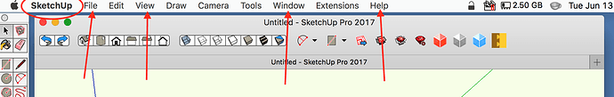

I can’t tell from your post whether this is an issue with your understanding of Mac in general or whether your installation of SketchUp has a problem…
On a Mac, application menus appear in the top stripe of the screen, not on each window. So, for example, while SketchUp is running the top stripe looks like this:
You will see the items you listed there when the SketchUp window is active unless something is seriously wrong.
Also note that there is a single toolbar across the top of the window itself. You can right-click this toolbar and select “Customize Toolbar…” to bring up a window from which you can drag additional items onto the toolbar or remove them.
At left in my screenshot you can also see a portion of the “Large Tool Set” toolbar. You determine which toolbars are displayed via the View->Tool Palettes menu.

Edit: And here’s an annotated screenshot to emphasize what I am talking about:
