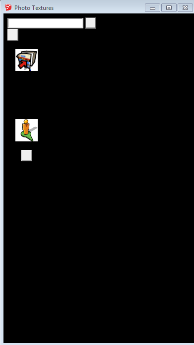

Also, this issue happens with almost every pop-up window in SketchUp 2015. Here are some examples. There just… blank.
