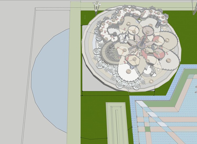

By trying do intersect the from the horizontal grass (a group)
or the building nothing works.
Got so involved within, that I actually deleted and lost all the grass
and had to re import it from previous save
it is 10mm thick not just one layer.

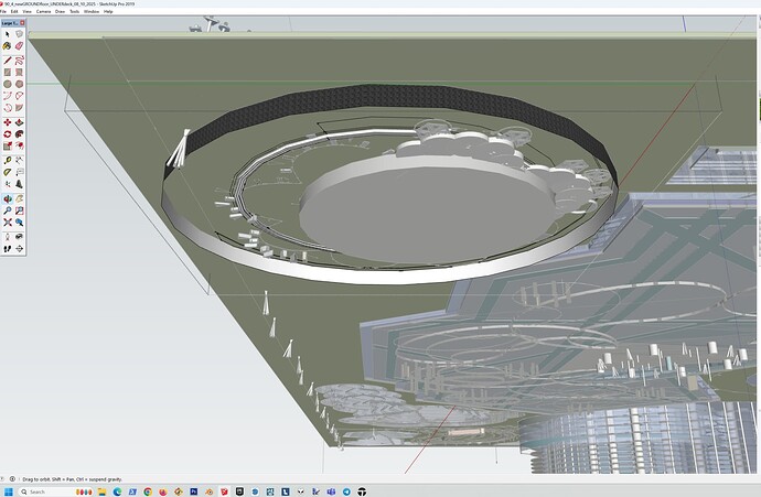

I made like a round deep circular pot around it hoping it will be easier to cut the grass out but
still not ( I made the bottom invisible in this screen shot) to show all the foundations going down
What ever I do SU still closes it up in a zap.

Somehow after x trying I found out if I start a circle at grass level OUTSIDE of the building with
a displaced center (compared to the building)
I was able to cut out the grass inside the building and the fill in slowly the outer open area
along the edge of the sidewalks
I am sure it’s not the easiest way or most logic but if resolves my current issue and now
I can finish the inner surrounding walls

When I run into weirdness with Intersect, I go to solid tools. This creates it’s own problems, but often I can get some of the intersecting objects to be solids (using the Solid Inspector extension). I then create a solid the same shape as the geometry I am trying to intersect and use solid tools>trim or >subtract.
Maybe this is helpful.
Also make sure you are intersecting faces in the right context..
