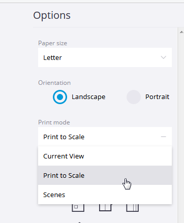

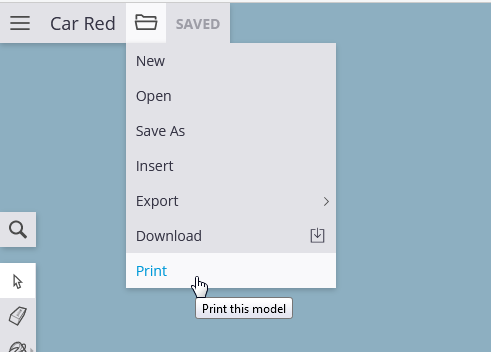

It appears to me you can print to scale, even if the UI is very spread out over the screen and all elements aren’t easy to find (like the cancel button if you don’t want to print).
2019-12-17_09h16_27
2019-12-17_09h16_40
2019-12-17_09h16_55
Wonder when that was added. Certainly since the last time I had reason to think about it. Thanks @eneroth3
