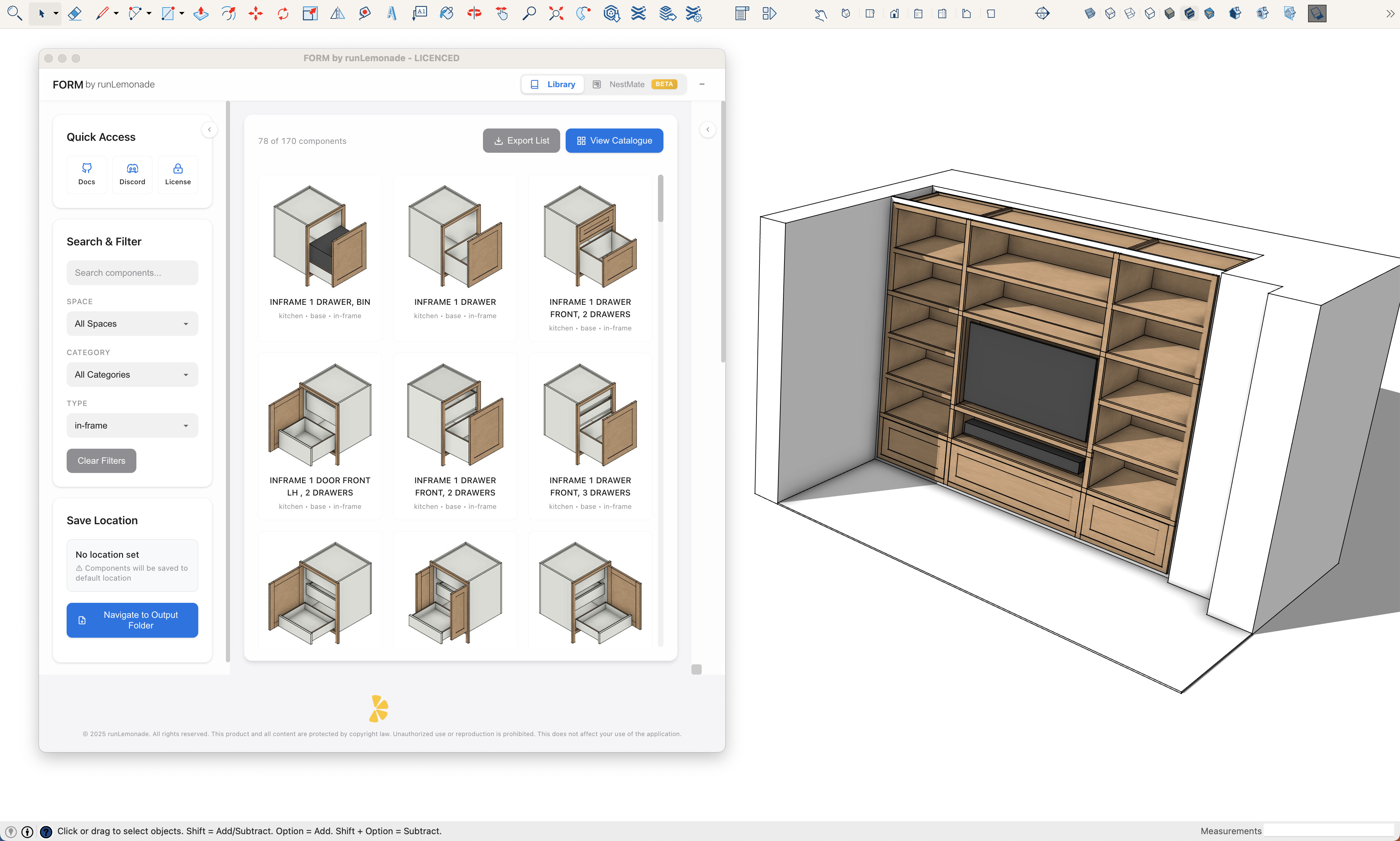

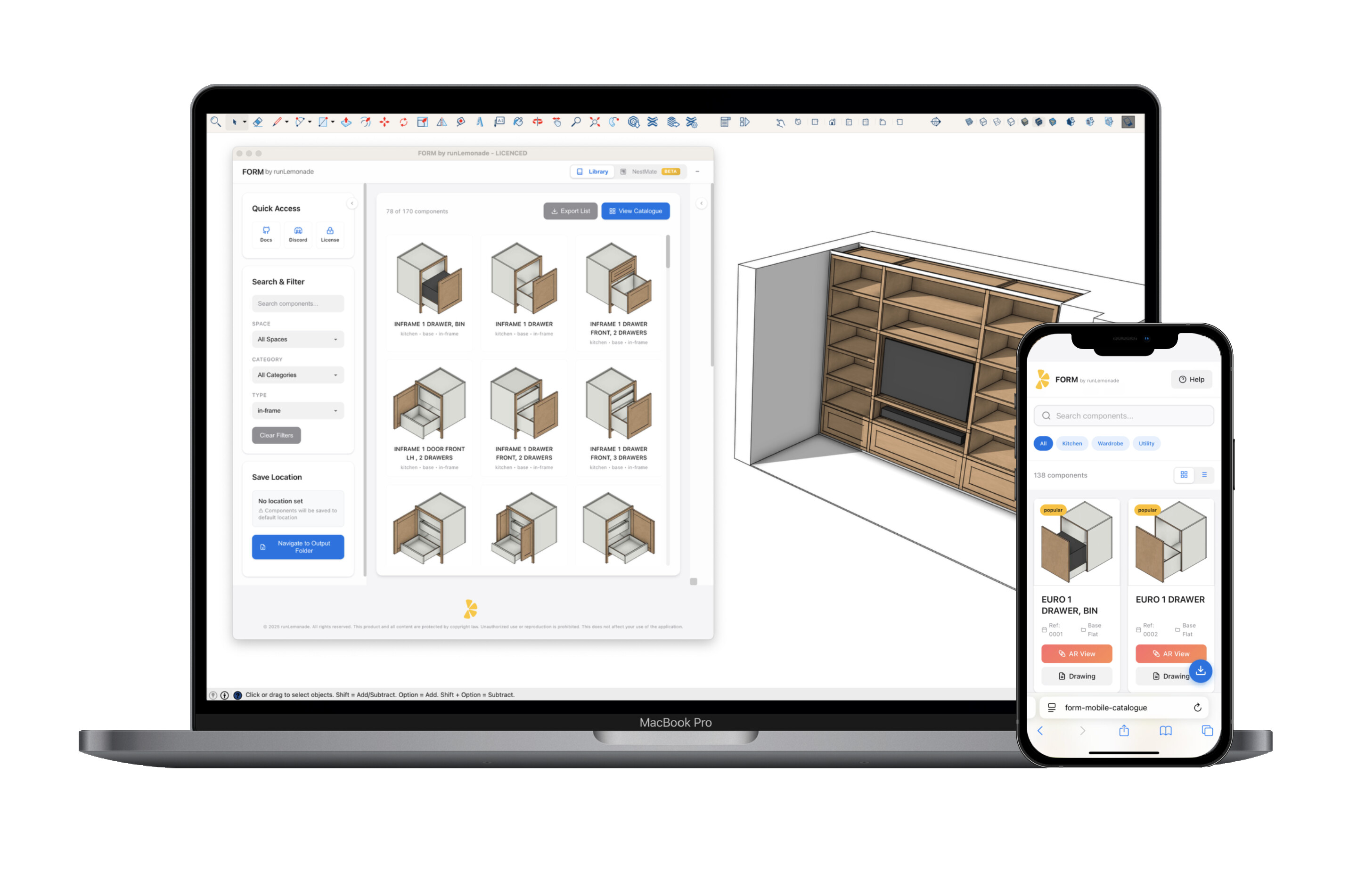

Well.. we are there and the SketchUp Extension is ready - currently being reviewed by the extension mangers team but you can download it at www.runlemonade.net while they approve.
It’s called FORM and its tailored towards metric cabinetmakers, Architects & designers. A click and drop system with over 150 pre-designed, dynamically controlled models. Updated with new models every month and an expanding features.
Supports SketchUp 2024 & 2025
I’ve done alot of back end work so keen to hear what the wider cabinetmaking & sketchUp community has to say about it!
