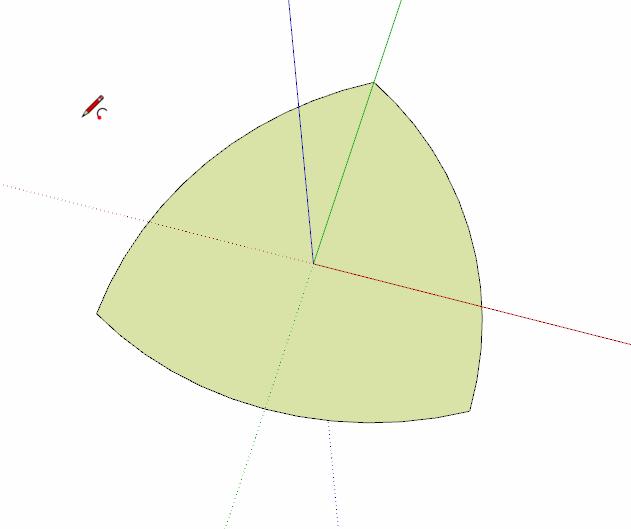

Are you thinking a Reuleaux triangle or do you want the points rounded as on a guitar pick, too?
Triangle to Reuleaux Triangle using Arc (not 2-Point Arc).
Then round the corners with 2-Point Arc tool. I drew one arc and then use Rotate/Copy to make the other two.

Pics come in all shapes and sizes so if you are designing your own don’t forget you can just eyeball it and mirror.

another way is to use Voronoi & Conic Curve plugin.
You make a triangle, select the tool ‘conic curve on face’ and boom. there’s your pick!
(you can adjust points and weight by pressing tab)
