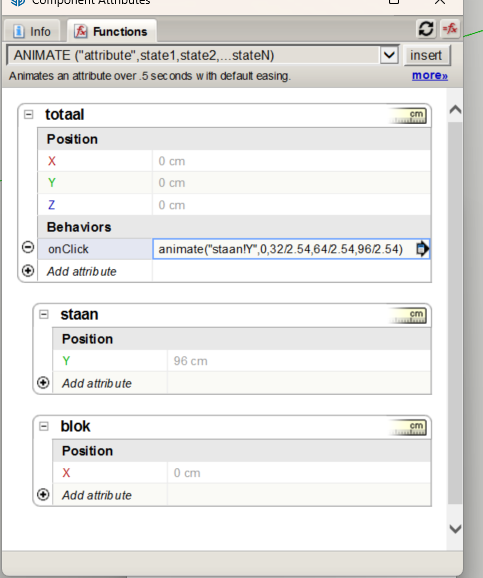

Because I havent been able to kill the bug.. I have come up with MY OWN SOLUTION:
As you can see in attached photo.. in the BEHAVIORS BOX I have devided all cm’s by 2.54.. which is the conversion value from cm’s to inches. The result is accurate.. and works perfect… I hope for the time being.. Because I expect SU to deliver the proper way of DC-sizing in centimeters.

Yesterday I posted the temporary SOLUTION I created for converting inches into cm’s.
Don’t hold your breath. As @Anssi indicated in his first reply, it has been this way since Dynamic Components were first introduced. It’s not likely that any change will come soon. It’s even more unlikely with the release of Live Components.
Hi Dave, Then perhaps my rather simple solution can help you aswell.. Look further down for the photo. It works great.. plus the “2.54” cm/inch-conversion will forever remain in my brain :grin:
