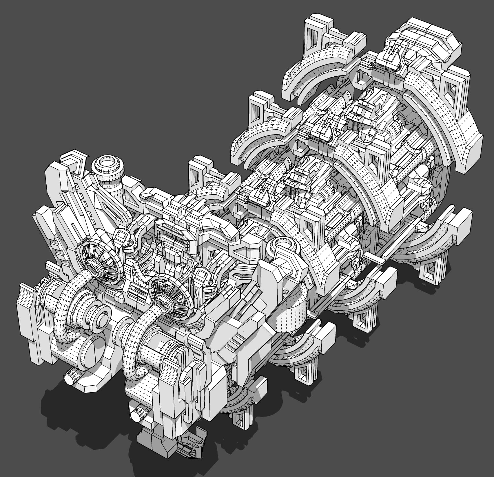

But in other news the dust’s settled and feeling recovered, have an idea for a creature, and viewing it as a more major project since it’ll be ~20 days rather than 2. Thinking a cool name like “project Starlight” would be a nice indication of the theme.
Figured out what project Starlight actually is, now for the fun part of going insane with the details
Was also feeling a little nostalgic and was sifting through old models, I’m noticing a big pattern going on
It seems that model ideas have been growing off each other, and these branches go on for long strings of related projects. The process of making them already kind of follows that pattern but it’s cool to see it’s happening at a higher level as well.
Might be fun to categorize them all and figure out where they’re actually coming from, it’s kind of fun imagining what the next one will be too :face_with_peeking_eye:
