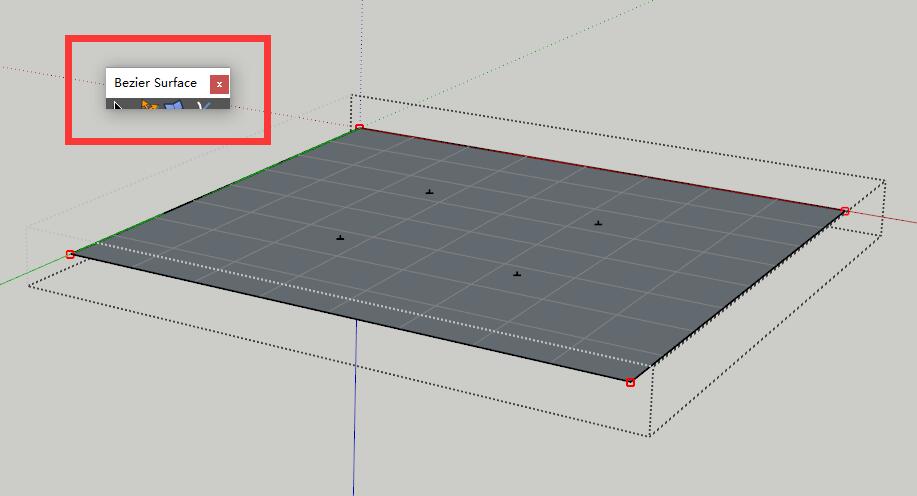

Hello, I really like your development of the plug-in, you are my idol!
Recently I was using Bezier Surface Tools, but I found that there was a bug in the UI UI and only half the content was displayed.
I logged this as https://bitbucket.org/thomthom/bezier-surface/issues/53/toolbar-size-is-wrong
