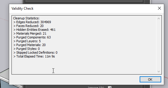

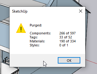

You should also get into the habit of cleaning house once in awhile. I purged unused stuff from your model and got rid of a bunch of stuff. I’m letting CleanUp run and do more looks like it’s got a little while to run. When it is finished I’ll return with the results.
Purge Unused:
After CleanUp
Your file is the third one. After all that purging and cleaning your file has been reduced by a little more than 62%. It’ll be more responsive then.

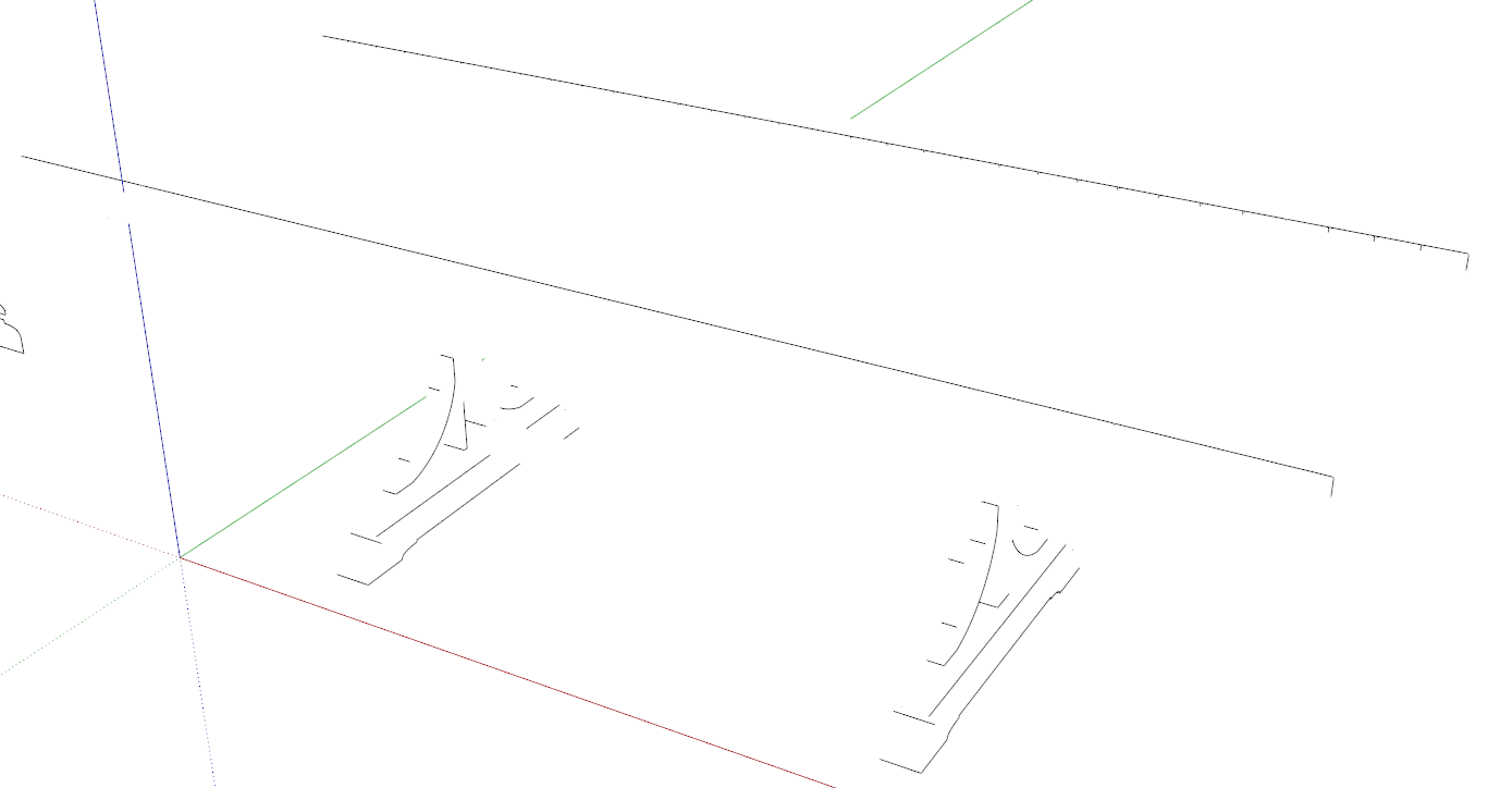

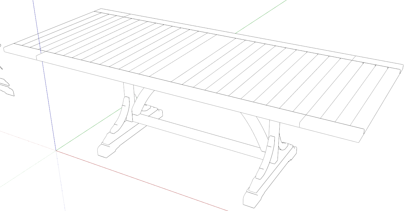

That’s not unusual. Profiles add some extra work for the graphics card. SketchUp has to keep figuring out which edges are profile edges as you orbit the camera. With Profile turned off, it doesn’t need to do that.
A lot of people will disable it. I don’t but I do leave Profile set to 1. Without profiles enabled, some things can sort of disappear, especially with the Hidden Line face style.
For me, the reduced frame rate isn’t really noticeable and the profile edges are more important than the little bit of frame rate increase I might see by turning them off.
Profiles are how SketchUp marks what it thinks should be the visible outlines of things in the view. Sometimes these are real edges. Heavy profiles can help you find places where an edge does not cut a face.
But other times, as in what @DaveR showed, SketchUp’s shading creates the illusion of a smooth surface. Because everything in SketchUp is represented as flat polygons, there might not be any real edge at the visual boundary of a quasi-curved surface. Without the profile, it wouldn’t be clear where the object’s boundary is. In fact the object can seem to disappear!
SketchUp has to examine the model based on the current point of view to determine where profiles should be displayed. Then it has to pass that information across to the graphics card each time the view orbits. If profiles are wide, it has to create the fake geometry to pass across. This extra work slows SketchUp down, sometimes quite noticeably.
