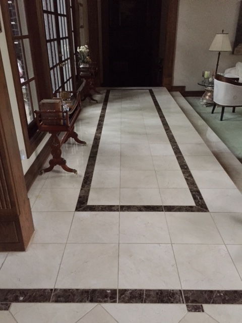

Sorry, I should have posted a better picture:
They’re 1’x1’ square marble tiles with a glossy finish. The rectangle is a different color tile.
Ideally I’d like to reproduce this as close as possible, including the grout, but if it’s too tough to include the grout that’s OK.
I agree with your thoughts of using a texture as opposed to trying to actually model the tiles.
I’m guessing I would need to get a good image of a tile and then possibly edit the image to include the grout lines, then “paint” it over the surface. Then, do the brown area on a second pass. If there’s a better way let me know.
One think I’m confused about is how big the image should be. I tried using a generic tile image I found, but when it tiled it looked weird of course. How does Sketchup decide how big to make each tile?
Thanks again.
I would do it like this. If you have one seamless tile you can insert your measure there and it will lay the way you want. Then right click over the surface and Texture/Position and arrange it the way you need.
In the Materials window you should be able to set what width and height the texture represents.
One option you have is to use your own photo as the texture.
floor.skp (313.5 KB)
My preference is to import the images as a material and apply it to a properly sized face. Then there’s no need to edit the dimension in the Materials window.
Apparently I did it exactly the same way as @ely862me, who beat me to it: (notice: the grout line is built right into the tile.) (If it isn’t obvious, both tiles are textures. They’ll just repeat themselves until they run into a barrier.)
-Gully
Wow, thanks everyone this was really helpful! I created tile images using GIMP to skew the edges parallel, then created new materials and positioned/scaled the image to fit. Very cool. Only thing I haven’t figured out (and it’s minor) is how to make the corners of the brown rectangle meet in a diagonal. No biggie; thanks again!
Just draw in the four diagonals with the Line tool, connecting the endpoints of the concentric rectangles (Although it doesn’t show clearly, like @ely862me, I mitered the corners.)
