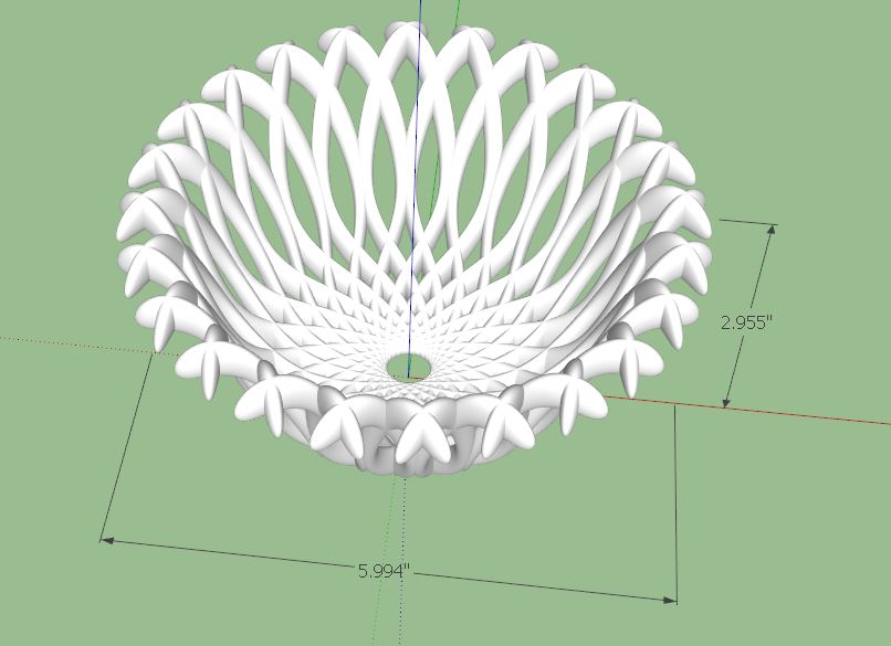

You can model whatever size you want, but the final, uploaded model must fit inside the 4 x 4 x 6 print volume. Your can model inside that size from the start, or scale to that size after you finish modeling.
I was just fiddling with a model for this and it hit me that the 6" direction is relevant to how the model can be printed.
I’m assuming that the 6" is the height of the print area? So if your model is such that it needs to be printed on a specific plane then the largest dimension on either the x or y plane must fit the 4" limit.
For example, this basket would not print well if turned on its side, but technically it fits the dimensions.

Will those overhanging curves print ok without there being a lot of supports? Of course, they can just add supports to solve the problem.
Yes the tips would need support in this position, which is basically why I was asking the question. On my printer the slope of the sides would be fine but it would print 24 little towers to set the tips on, they would be easily snapped off and cleaned up once printed.
You don’t have to print the object flat to the ground, you can position it however best suits the construction. Therefore it helps to know which axis is the long dimension. I’m assuming it is the height, but no doubt there are some printers that have a rectangular bed.
None the less I didn’t bother continuing with that design.
