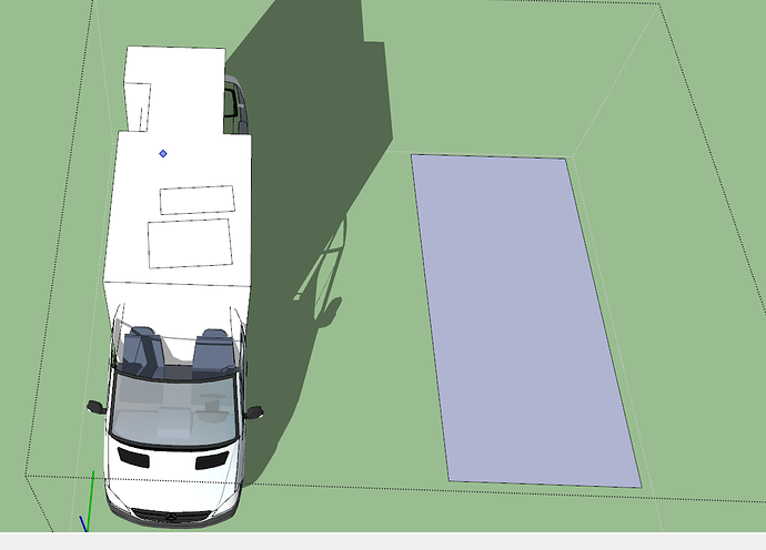

Hello, I have a problem, I downloaded a 3d model from a van to fit it with Sketchup … I drew the floor well in the axis, but now when I draw a rectangle on this floor, this rectangle is not in the axis it is shifted by some degree if I draw a rectangle on the floor, outside the van it is symmetrical to it . How do I do that?

Well, it isn’t the axes after all. It looks like the problem is due at least in part to the fact that the floor of the van isn’t level. The guideline is horizontal and I’ve drawn a triangle that shows the slope.
You could press the up arrow cursor key to lock the orientation for the rectangle but then it won’t lie on the floor. You could use the Line tool to draw the rectangle at the slope or you might find it makes the most sense to fix the floor and make it level.
