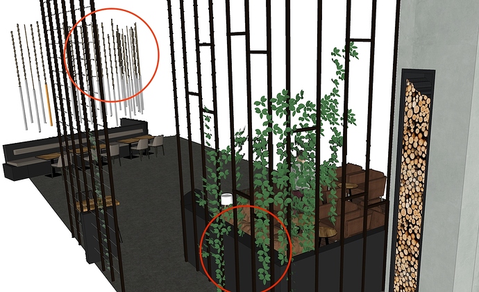

I had the same problem … with export to 2D jpg.
When I export a scene as a 2D Graphic, the anti-aliasing in the exported image is not matching what I have on my screen. I haven’t had this problem with previous versions of SketchUp (I’m using 2017 Pro). I’ve adjusted the AA settings in my preferences, but it doesn’t make any difference. Also, it does not matter whether I export as a jpeg or png.
Please see the attached image. Any help is appreciated. Thanks!
[image]
but I noticed in one of my jpg that when there was an object behind my model, the anti alising was ok…
test 1> so i started by creating a huge cube around my model> anti-aliasing was ok in my jpg !
test 2> show the sky and the floor in the window style, changing the color to white for both : anti-aliasing was ok too
hope this can be helpful for others

2
An old trick for getting decent antialiasing in Sketchup image exports is to export your image to about 2 x the intended final resolution, and to downsize the exported image later in Photoshop or your image editor of choice.
