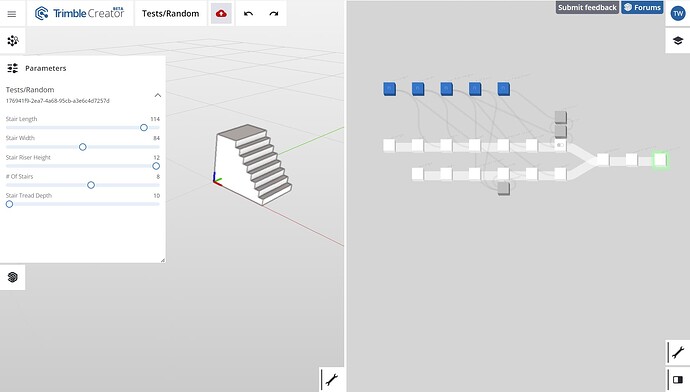

Found quite a fun way to solve creating a simple staircase like you were trying to do @vlapredbv. I know it’s different then what you were doing with the align nodes, which as I mentioned could be fixed, however to get a result of a staircase that can create infinite amount of stairs without needing more nodes, check this out. The fun thing I tried was just putting a simple box boolean together against the offset stairs. Click through the graph to check it out, the box cuts the stairs off when it goes over where the box is aligned too, then you can group the box and stairs (other boxes) together and move them around as one object (a staircase). Plenty of ways to improve the graph for custom parameter functions but wanted to keep it simple here and not wander off the topic. Get creative with your solutions!! This was fun, and now it’s late, time for bed.

Also, one more way you can make the graph smaller and more flexible is using a copy node with 1 box instead of the 4 or 5 you have, then a get primitive or maybe even better a delete primitives combined with a boolean list which would simply get primitives you wanted to redimension off of one paramater. For example you could setup a custom stair dimension paramater effecting riser height or tread depth or both, then 1 more paramater to toggle the stair number you wanted to custom redimension and adjust it, that’s what the delete primitives combined with the boolean list would let you do. This way you could have infinite stairs and adjustments with 50-90% less nodes in the graph making it more parametric.
