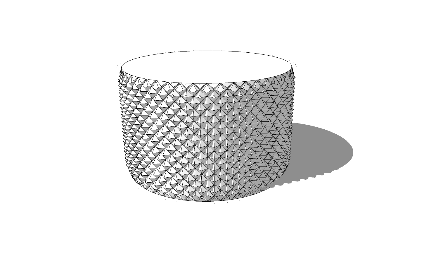

Yes. But now I’m trying to do a knurling. Let’s see if I can.

I did this. I don’t know if I’ve been.
That looks nice but it’s not exactly right. Look how the diamonds are aligned on my last screen shot.
Ahhhh… of course. You made a negative of the knurling and cut it out of a pre-tapered shaft. My eyes are opened, little tricks like that are what make you a Sage. Thanks for explaining.
@ecati Having machined knurling on a lathe I can say that it would be very hard to make your knurling in reality, without the pyramids aligned in a grid. Looks cool though.
Yeah. Pretty much like that.
