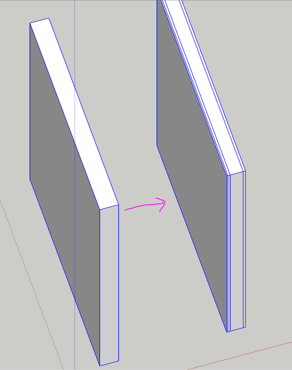

I’m wondering if anyone knows of an extension (free or paid) that could simplify the process of turning a basic 8" mass wall into several different grouped solids. Essentially turning an 8" “massing” wall into an 8" wall that has 1/2" gypsum, 5.5" stud, etc.
