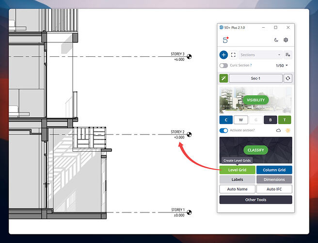

Hi @armin
To show the level grids that defined in Building Info, you should use button Level Grid.
The level label from Labels is used to create this symbol and it is required to select an object or a horizontal face first.
Hi @armin

Re: the level grids: I am using the button you indicate but nothing appears.
