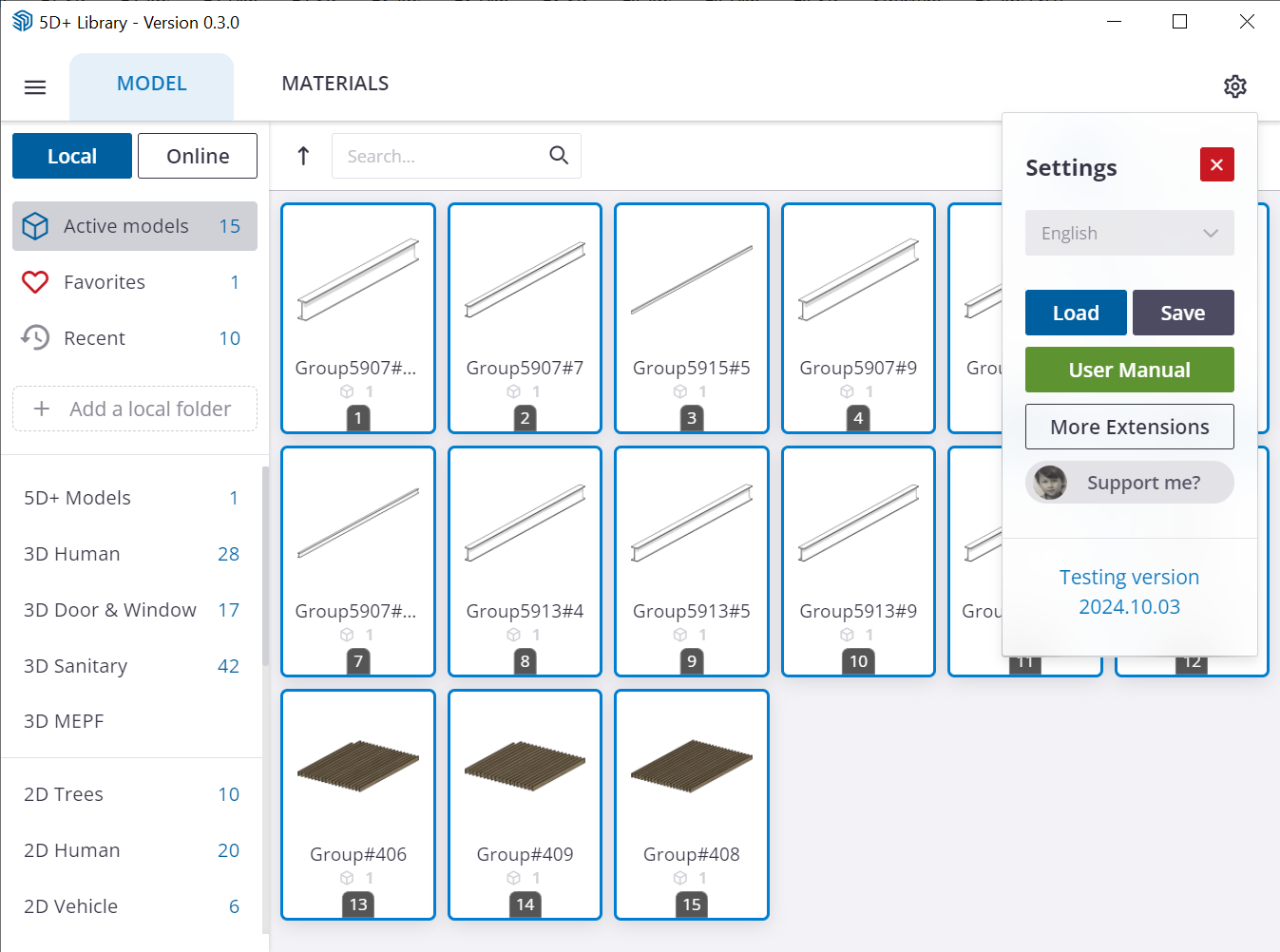

Hello, this extension is currently in testing phase. I send you the link to download via pm.
Aha! That’s great! Is it in the download link already? I will install it after all… :smiley:
If about the latest size of minimize the dialog, not yet.

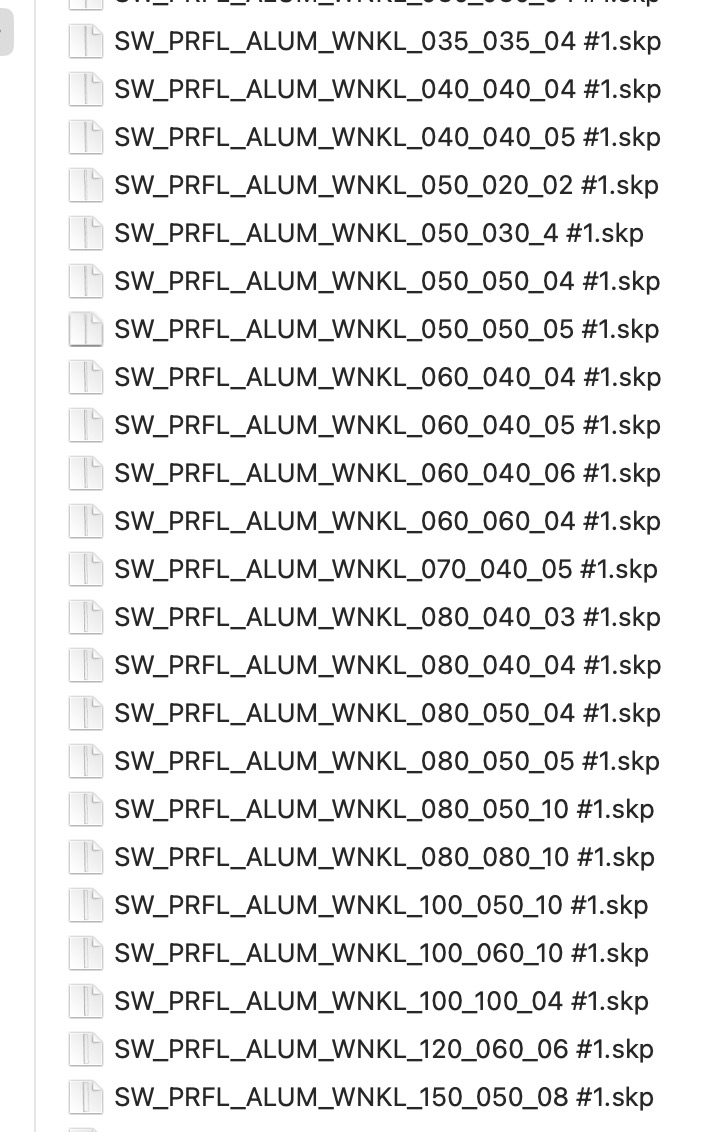

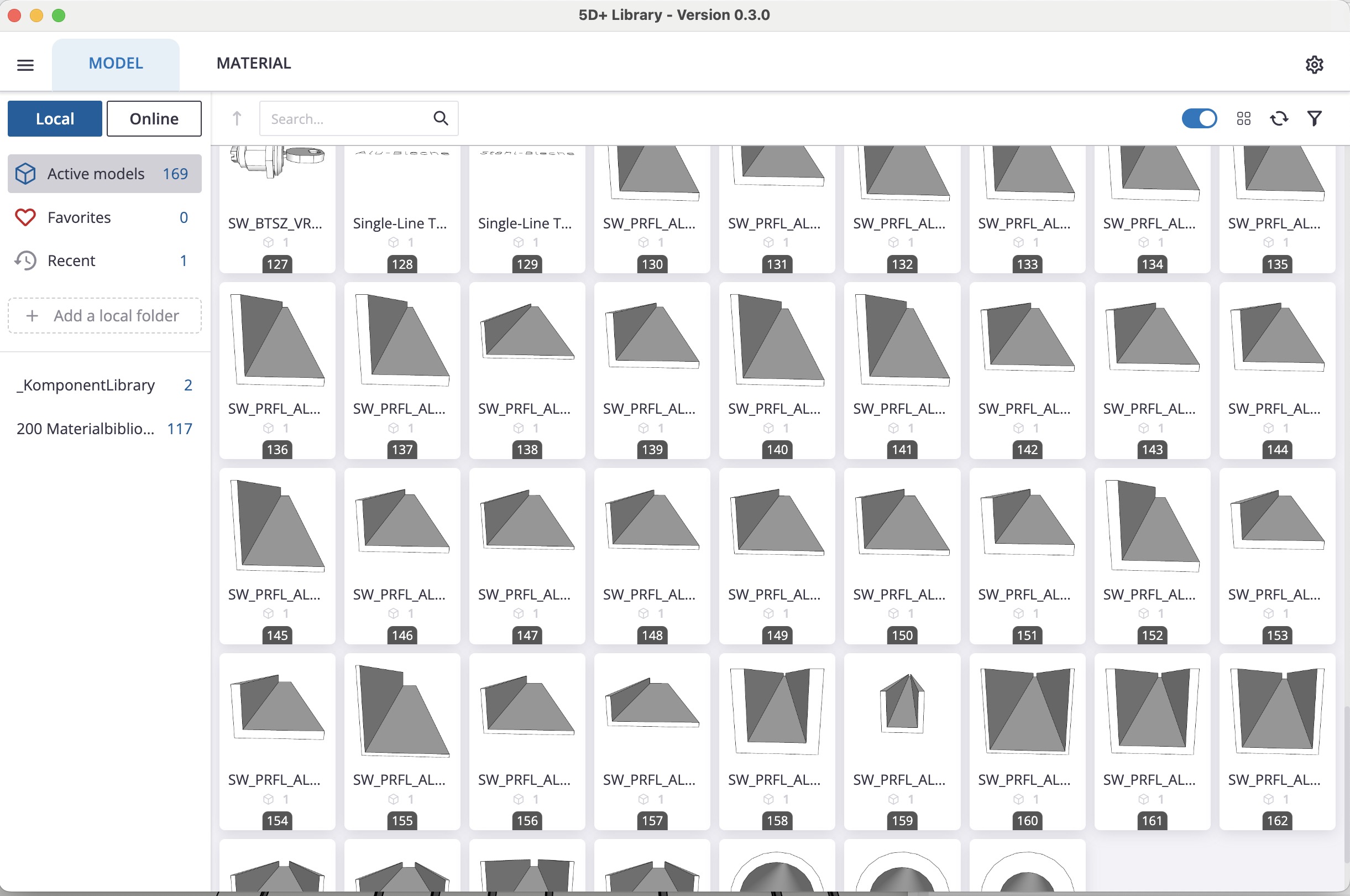

What doesn’t work so well is the naming. As you can see in the screenshot we have a whole bunch of very similar components. So the first characters of the files name is always the same. As the component browser cuts the naming of after a few character you have no idea which component to pick.

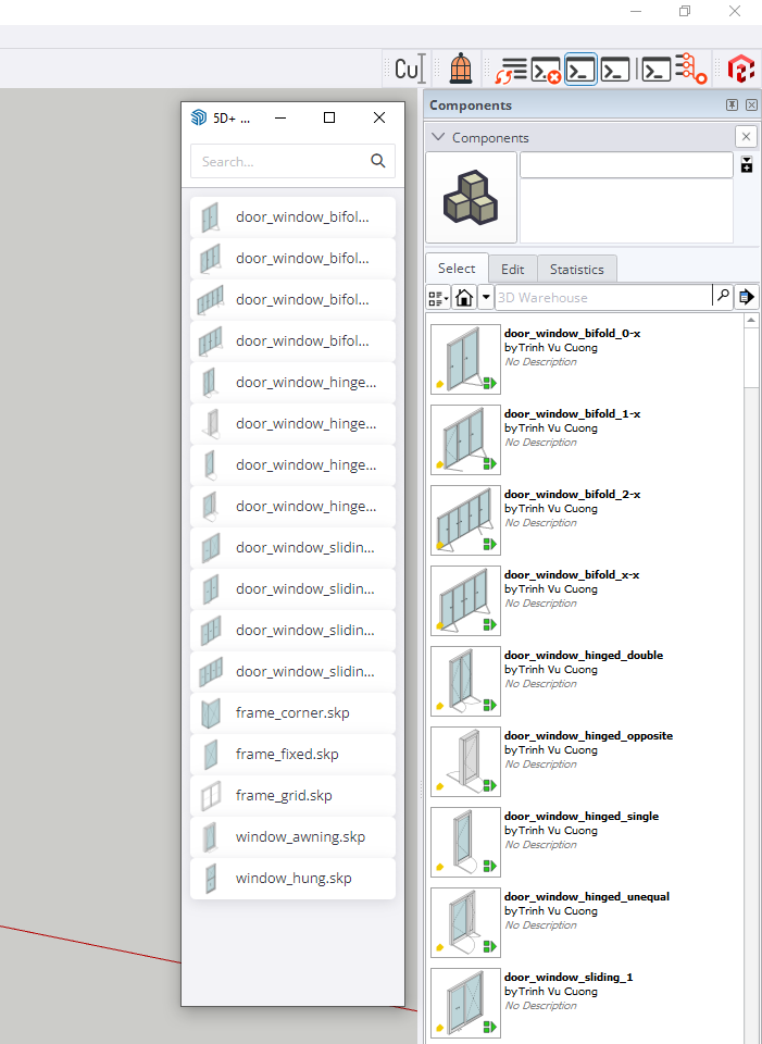

Another interesting thing - the screenshots of the components in the active file browser and the saved-out components are rather different. I like the ones from the active file browser better - they show the item a lot better. Not sure if this solvable though as it has likely something to do with the component axis.

Before saving out the components, let check multiple components and rename them. The extension has ability to bulk rename with a prefix + sequence numbers (001, 002, 003…).
When you are browsing in “Active models” collection, there will be an “Update thumbnails” button. You can use it to force SketchUp to update the thumbnails for components are displaying. After update, the thumbnails in active models will be matched with thumbnails of saved components,
You can use “Load” and “Save” to sync the settings between members in your team. But it only works if your library has the same path in every computers.

Hi @Cyentruk → What I meant is this - it would be great if you wouldn’t cut off the component names in the viewer but rather wrap them so that the full name stays readable. There are very specific reasons of why we name the components the way we do and the differentiating bit is always in the end for sorting purposes…
