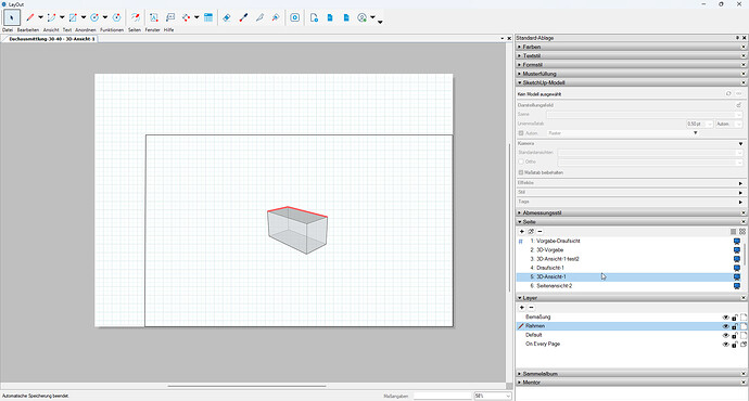

I have a SketchUp file with multiple elements, all approximately the same size. I have exported these as different scenes in LayOut. As far as I can see, all the parameters are the same: camera position, projection, scale… But two of the pages with the imported scenes are much smaller than the others. Since I want a perspective view, I cannot switch to “ortho” under “camera” as it would immediately switch to parallel perspective.
Am I missing a setting?
I have attached screenshots. Number 1 is as it should be, and number 2 is the element that is too small.

What happens when you select the sketchup model view in LayOut - can you reset the view?
Did you copy the viewport from page to page? Or did you duplicate the page and then change the scene in the view?
In the sketchup view pallet is there a lock on resizing the view?
Post your file here and someone might be able to look at it and figure it out.
