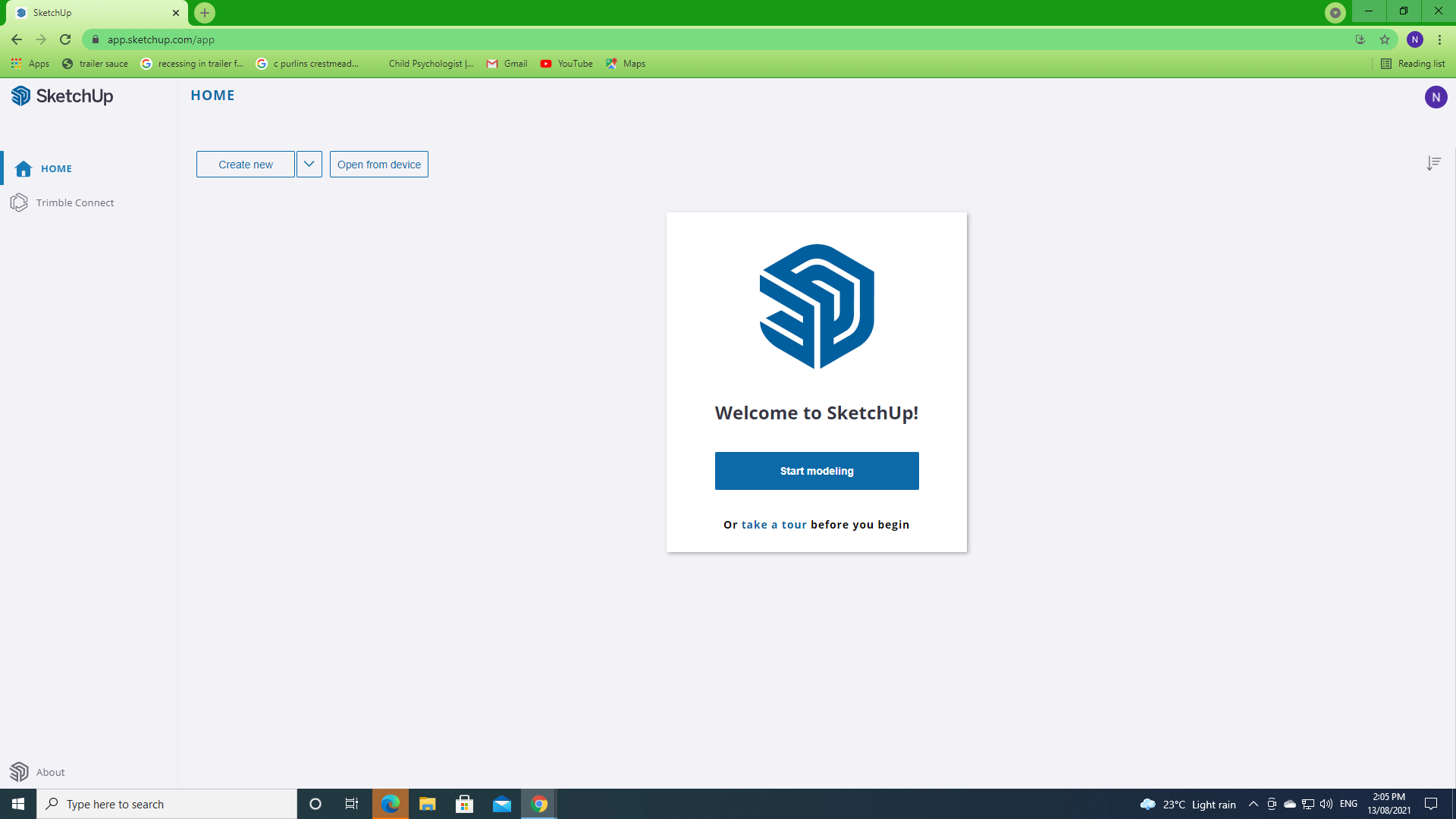

Hi, I am hoping that you can help me. I am not tech savvy being an old carpenter, but here is my problem. I used Sketchup free and saved about 12 models over the past 4 months on trimble connect. They are not big files as they are pretty basic 2d drawings. I went to open one and when I clicked on sketchup home they started to load with the flashing circles indicating that they are loading and then they stopped. When I went to trimble connect there is nothing there but when I click on home, they start loading and then stop and then nothing. Everytime I click on Sketchup home they start to load and stop but nothing on trimble connect. Can anyone help me. Thanks. Nick.
What stopped? Share a screenshot or two of what you are seeing.
When I click on home, I see the 9 of my models loading (screenshot1), then it stops loading, the screen goes blank and then I get a welcome screen (screenshot 2).
Ah, now I see :slight_smile:
The loading of the thumbnails of the ‘recent files’ is not working for the Trimble Id that’s currently active.

When I went into incognito mode it led me straight to my models. I couldn’t get to them unless I was in incognito mode. Now when I click on the model in trimble using my normal account it takes me to the account that shows me nothing. When I try to access my models via trimble connect from sketchup it takes me to the account that has nothing in it. What do I do now?
The incognito tab was just to make sure to login with the correct email address and not to have it ‘automatically filled in’ by the cookies of the browser.
So you might wanna clear the cookies of the browser, then login with the same credentials (and use the same sign in options) aa you did in the incognito tab.
From then on, it should be ‘remembered’.
Thanks to you I now have my models back and can access them from Sketch up. I can’t thank you enough. In Australia I would call you a dead set legend (that’s a compliment). Thanks for your patience and your wisdom. The only thing that it doesn’t want to do is save my models to my hard drive, it keeps wanting to create new files with the same name in trindle connect via the save as function, so if you have some final words for me on that I would be grateful. Thanks again, I really appreciate the help. Thanks. Nick69.
