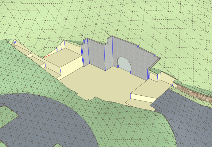

I always look to learn more on site work. I would like to see more methods that work in an organized manner for well organized models, because it seems I do it differently every time!
Having an accurate terrain is one thing. I can usually get that for my projects. Creating a neat and consistent grading and excavation model in an efficient manner is another. While modifying a building model throughout the design process can be straight forward (walls go in or out, roofs go up or down etc.), the intricacies of designing and modifying site models (terrain combined with hardscape, makes the task seem nebulous at times.
Hi, I design gardens so managing the terrain is one of the main things that I have to manage. The process that I have developed for measuring and modelling the site allows me to do it reasonably accurately. Creating the grades and calculating cut and fill is more complicated and sketchup could certainly do with some better tools for this but I don’t find it too complicated.
There’s a plug-in for cut and fill. I convert my terrains to solids and keep the copy of the original.
Gradings is harder. Can you explain better what you need to represent for gradings?
Thanks. I was just referring to possible video content.
Always interested in ideas for site work. Here is a recent project. I did not necessarily have to show the building excavation ( the yellowish parts) but it helped in logically laying out the perimeter elevation (I think). Most of what I have to do is show a finished site model as well as use the model to work out design. you can probably tell the lighter green is the original terrain and I do always save an untouched version in the model so I can go back to if where needed. Don’t need cut and fill calcs. very often.
I’d advice you to be less worried about the mesh. It’s probably too dense for easy modelling.
