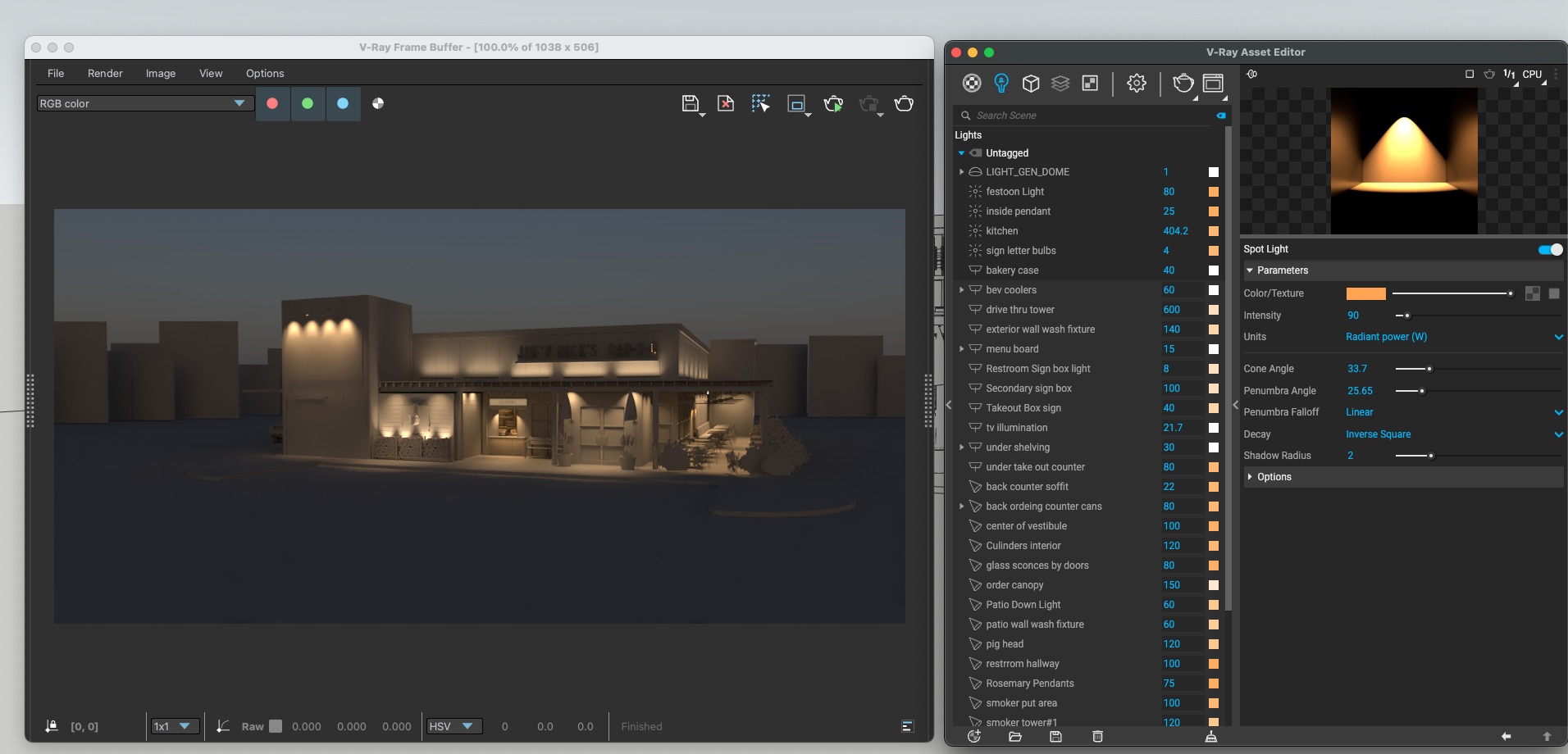

all up to date versions. from one model to another, something is causing one of my models to have to lighting at all. All the lamps are there and the settings are all good. somehow not one lamp is working on this particular model.
When I opened the file all the lights were turned off. Turning them all on (except the sun if you’re using an HDRI/Dome light) seems to work fine.

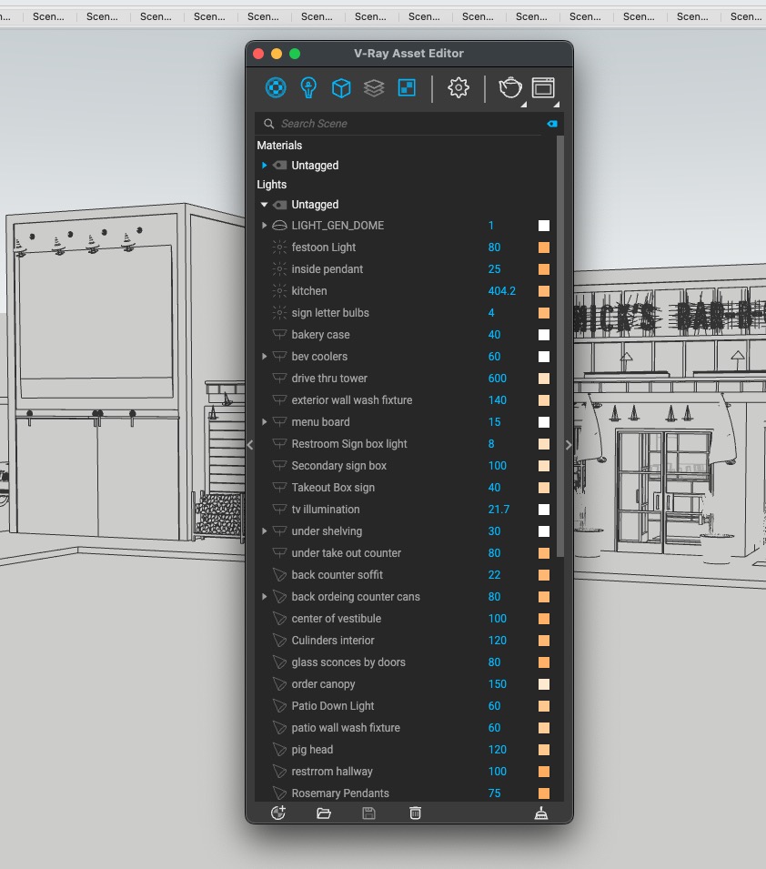

hmm, how does one “turn all the lights Off?
I see that. very odd. all of them are off individually..
thanks for looking
I can’t say why they all turned off. Perhaps Chaos likes to pop little ‘challenges’ in from time to time just to see if you’re paying attention. It’s also unfortunate that you can’t turn them ‘all on’ at once. Easy enough to click each one on again individually.

You’ve used lightgen - when you do this there is an option (which is ticked) to disable all lights.
