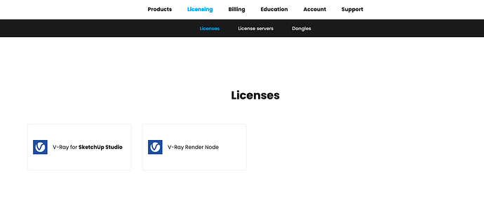

Hi can you help me with my V-ray issue?
click yes. and go to the chaos license server web interface I guess.
once connected (using trimble as a login), on top click licensing, and see what licenses you have.
that’s all I can say for now, I’ve had it only recently and still haven’t put my hands on it. but other users will probably know more.
also, it can be a good idea to contact Vray on this one too.
