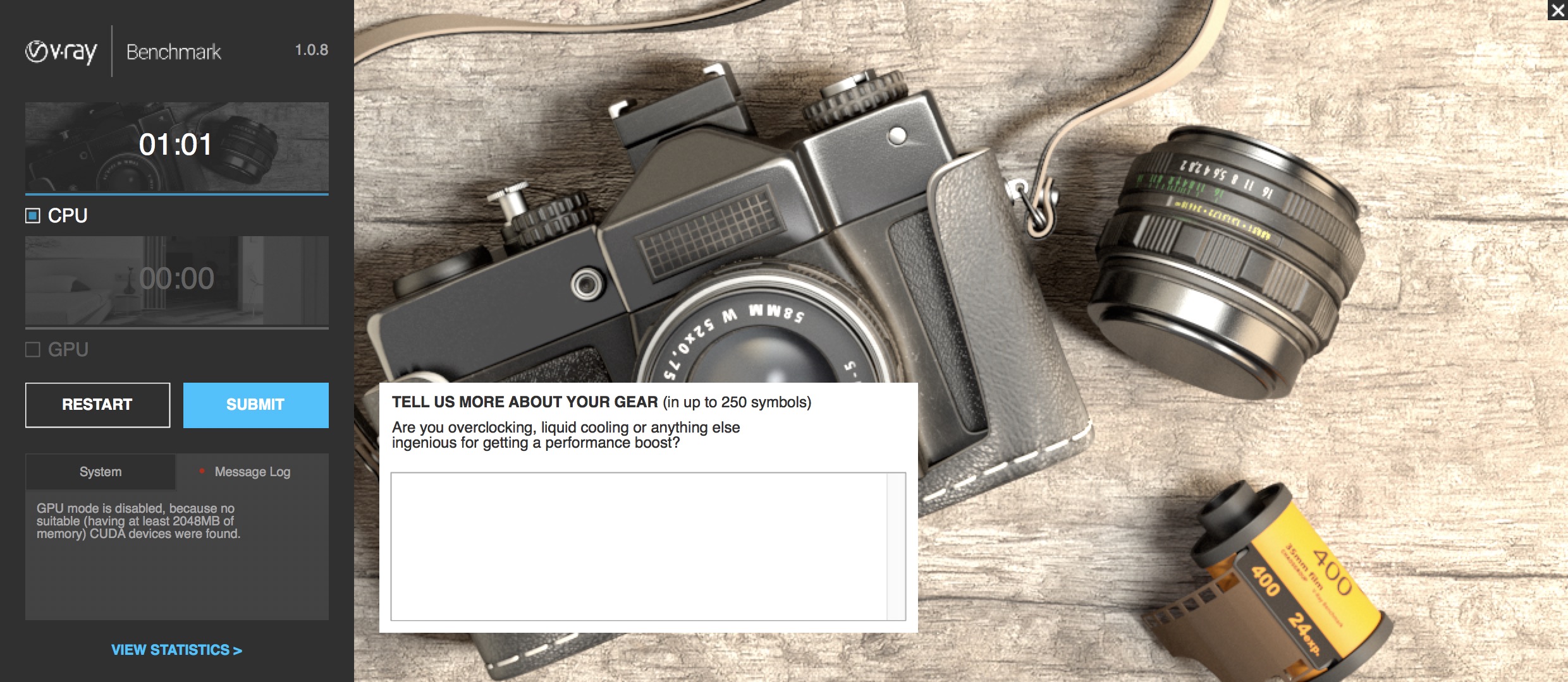

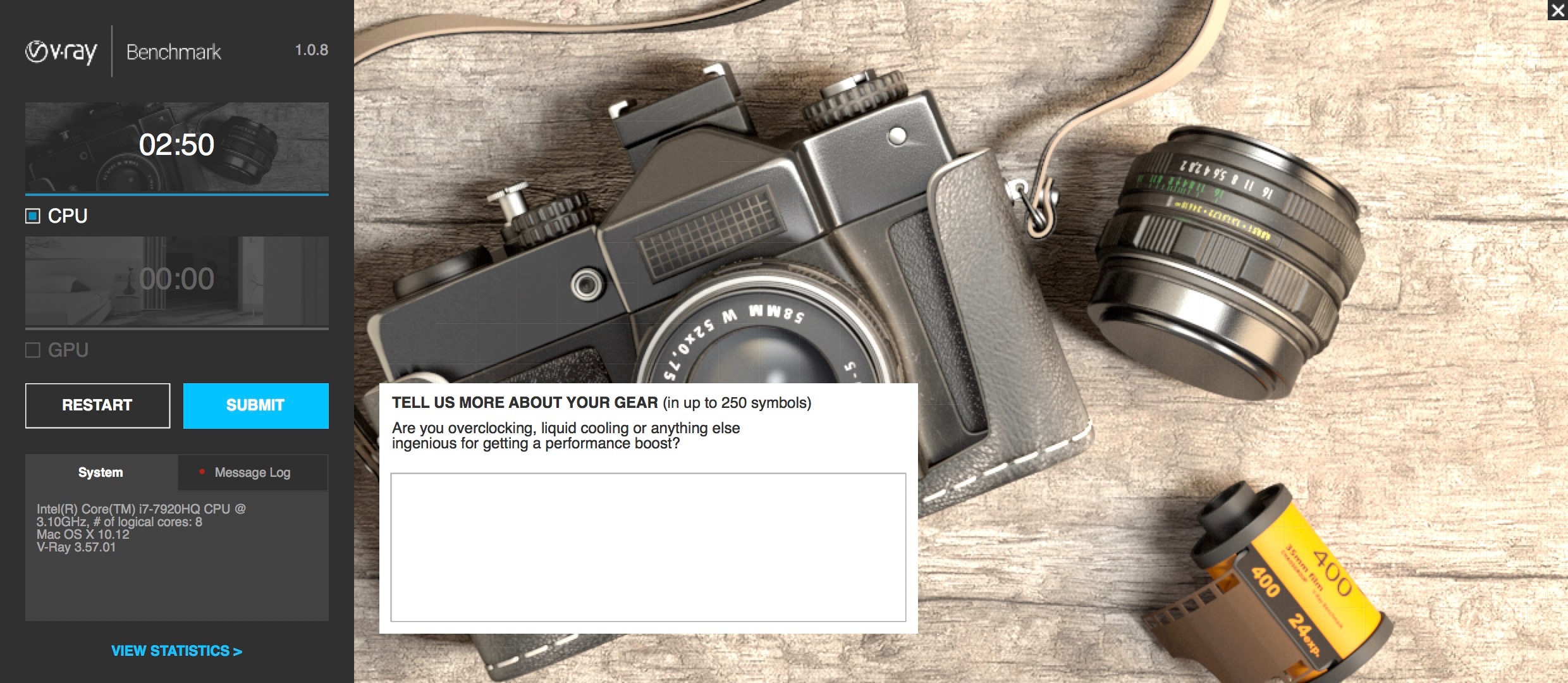

My set up is currently with the 10-core 32 gb ram Radeon Pro Vega 64 with 16GB of HBM2 memory iMac Pro. It’s lovely. No fan noise, no lag, nothing. Rendering times are about a third of what my top of the line Macbook Pro are.
I don’t have any experience with eGPUs and so can’t speak to those. I do know that on my iMac with VRAY I can choose between CPU, GPU or Hybrid rendering modes. I haven’t done clock speeds on each mode as CPU generally works fine. My background is landscape architecture so I’m rendering huge amounts of vegetation. If it can handle that easily then i imagine medical devices would be fine as well.
If you have a model I can do a speed test for you for comparison of your current or previous system setup.
Edit: here are my benchmark tests between Macbook Pro and iMac Pro…while running video conference.
