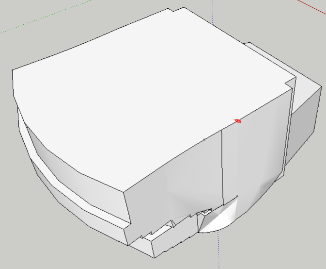

@StandUp, your solid isn’t a solid by SketchUp’s definition. There’s something odd going on. If I close the opening I found, the group isn’t reporting as being a solid anymore. Maybe there are other openings that also need to be closed.
Zoom in on where the red dot is placed to see that the group is open, not a manifold:
And

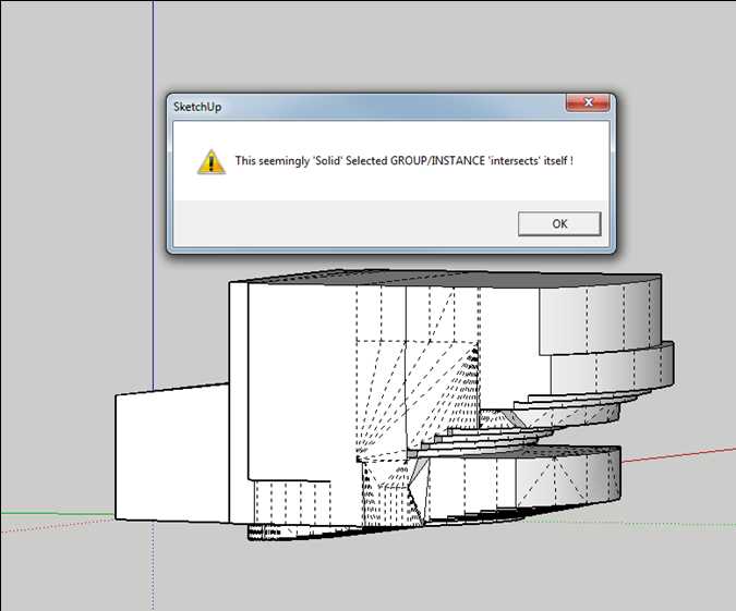

Solid Inspector2 says: (even though the faces don’t appear to be reversed)
650x424
Tig’s Solid Solver says:
I don’t see an easy fix to this one; although one of you genius modelers could probably redraw this quickly with a watertight skin.

@StandUp & @all, can anyone verify that the object in the fourth post, Volume Calc.skp (512.6 KB), is not solid (completely closed) although SketchUp reports it as being solid.
I can’t imagine that the issue was related to inproper use of layers.
(also see my previous post with screenshot and little red mark)
I confirm the small hole as you marked it.
This kind of weirdness has been reported before.
There are 3 edges in that group with only one face ‘visible’, and that should make it non-solid.
And of course SketchUp misreports it as a solid !
Using Ruby those 3 edges all report 2 faces - the ‘bow-tie’ issue with faces twisting around corners seems to be the culprit. The shortest of the 3 edge.faces reports the same [seen] face twice - weird that is a data base glitch. The other two edges return the expected face plus another face sharing a vertex of the edge, but it’s not a side of that second face - although face.edges returns the unrelated edge [same one in both cases] !
The improper use of layers won’t have helped, but I suspect that the Unit settings, snap etc and very slightly non-planar faces etc could result is SketchUp miscalculating the volume relative to the origin incorrectly.
Deleting all layers, pasting it into a new model with more sensible Unit settings seems to jolt SketchUp into correct action - although the tiny hole still persists and doesn’t affect its ‘solidity’ as you should expect…
