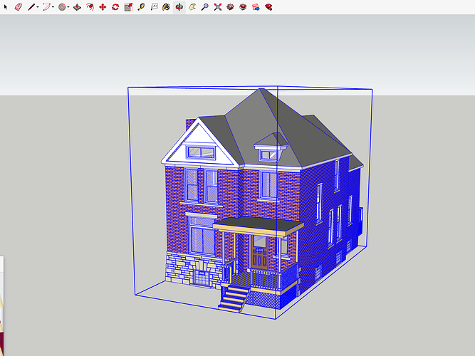

Update: got it to work. Walking through tutorials now. Trying to figure out how to get a sketchup file to work in them eventually

Yeah, I think Liamk887 was right I was trying to install the beta version, which needs a thing that’s windows only. I’m installing 4.19.1 now w no problems so far. at 71%, so I guess we will see.
How did you get your SketchUp models into Unreal? I’m currently trying an exported collada file into unity (which apparently I already had installed on my computer?), which seems to be working, but Unreal only seems to accept .fbx? Do you have any recommendations for a converter?

I almost always use Blender as a go between, so .3ds export from SketchUp.

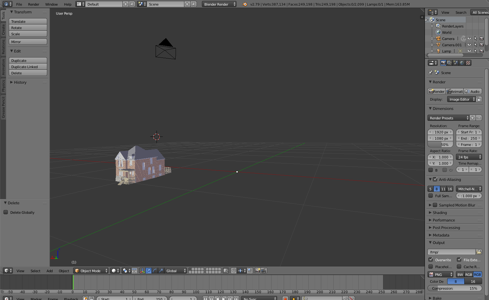

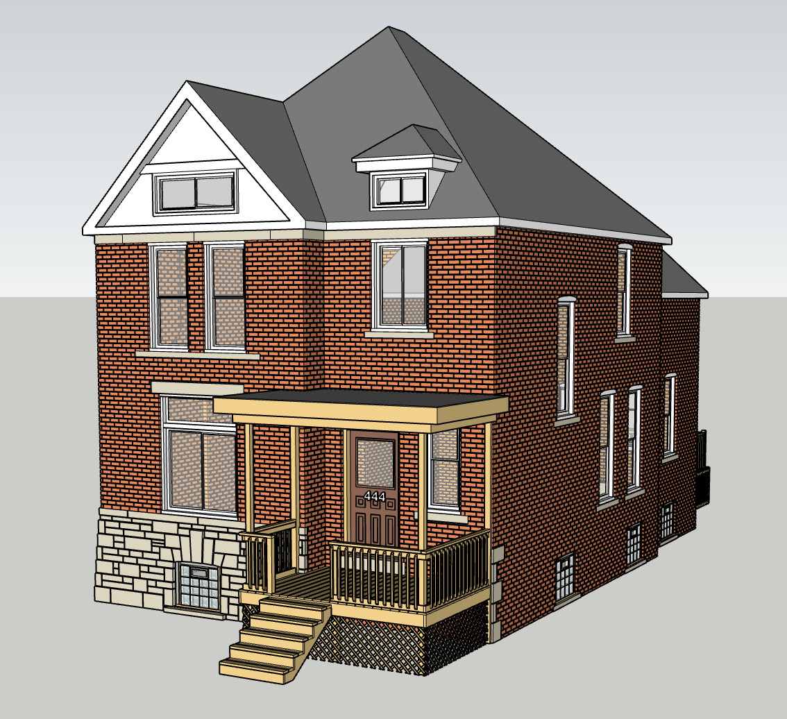

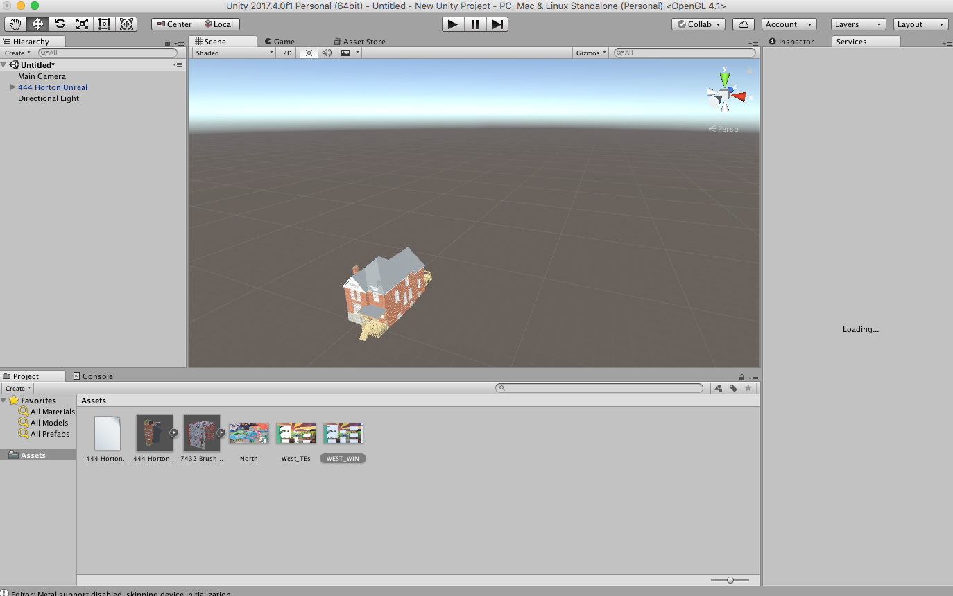

@liamk887 Got it to load on both Unity and Blender pretty well so far. Importing from Blender into Unreal isn’t necessarily going so well!
Original in SketchUp:
Here’s Unity
Blender:

I always go via Blender rather than straight from SketchUp.
