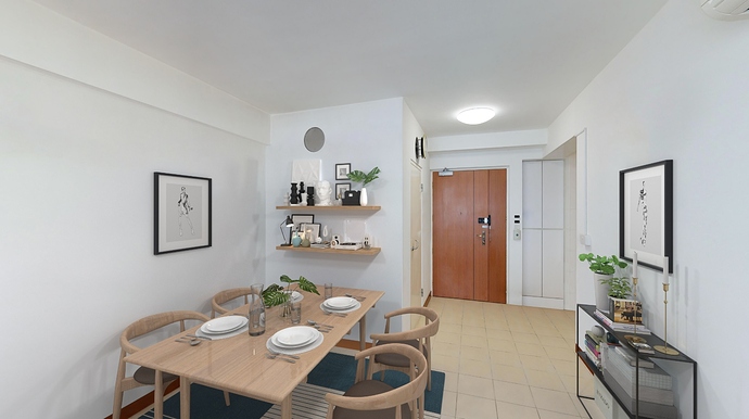

I want to do something like this, so Match Photo can do similar images.
Photo1 is before and Photo2 is after
It’s not clear what is your starting photo. Is it a completely empty room into which you will place furniture, or is it a photo of an as-furnished room and you want to substitute other furniture. SketchUp is not a photo editor, it can’t do the second.
Hi slbaumgartner, it’s a room filled with furniture, probably what I was thinking to do is to use photoshop to remove the furniture in Photo 1 and populate it using Photo 2.

Removing furniture with Photoshop is all a matter of Photoshop skills and tools, so there are other places to look for help with that task. This example is close to a one point perspective, so it might be a problem for SketchUp to Matchphoto with, but it might just be enough of a two point to work.
