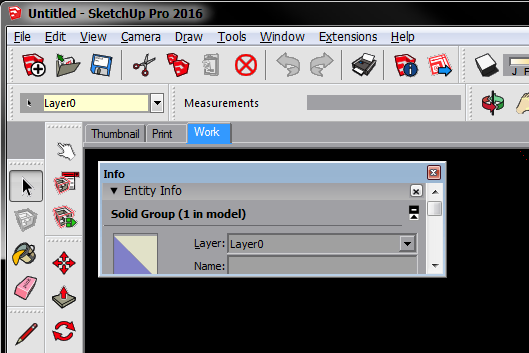

The new entity info tray seems to have quite some wasted empty space. Both with show and hide details. On win7X64. See red box in image.
Edit: the other trays can be scaled, this one can’t.
It’s there for hidden fields that only show up for certain selections:
They are panels, not trays.
You can create a floating tray just for that one panel if you wish, then size the whole tray.
Example:
