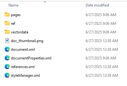

The XML files by themselves aren’t enough. Are there any folders in there with the XML files. You should see something like this.
Yes I see all that
Can you select the first seven and the last file and zip them up?
I zip those 7 files and it worked!!! thank you thank you!!! Lost some work but not hours. You are a lifesaver!! :clinking_beer_mugs:
