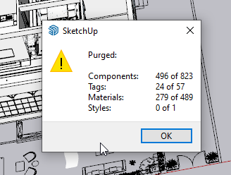

It would help to clean up your file. I fixed incorrect tag usage and purged unused stuff from your file. That reduced the file size by about 64%.
Wouldn’t hurt to get rid of the excess geometry in your imported CAD file. The bounding box shouldn’t be so large and if you don’t need the extra floor plans or any of it, now that you have a 3D model, remove it. There’s some hidden geometry a long way away from the floorplans. If that isn’t useful, erase it. Maybe that other hidden stuff could be removed, too.
