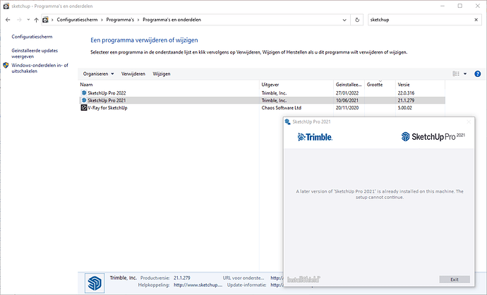

After installing SketchUp Pro 2022, it’s not possible to uninstall SketchUp Pro 2021.
When following the uninstall instructions, an error appears.
Uninstalling SketchUp | SketchUp Help
A later version of 'SketchUp Pro 2021' is already installed on this machine. The
setup cannot continue.
Trying to download and run the SketchUp Pro 2021 again (trying to solve this problem), gives the same error message.
