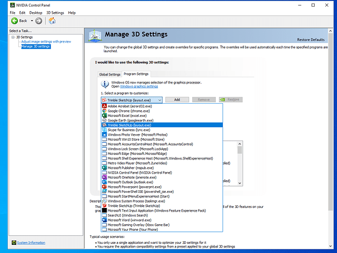

Have you checked in the Nvidia control panel 3D application settings that SketchUp is set to use the Nvidia card?
No error, just a bug splat screen…
How to check those settings??

right click on an empty space of the desktop. If no options appear, goto:
and download the latest.
Tip: when installing, be sure to have the notebook wired (battery) and run the downloaded file by right clicking on it and choose ‘Run as Administrator’

so, what happens if you right click on an empty space? Do you see the NVidia settings?
Other ways, type in ‘Control Center’ in the bottom left corner.
Once opened, be sure to set the ‘Strong Graphics Card’ to be used. DO not let Manufacturer’s bios or Windows decide for you, they will always choose the internal Graphic Card to uphold battery usage claims.

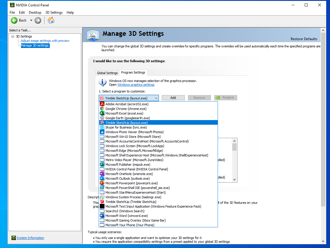

Mike, sorry I noticed that setting after I made a screenshot, I applied the change as you advised, no luck.
