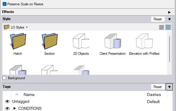

There might be a better way, but off the top of my head…
As per the DaveR method - a single modelling style in SU for the model.
Then have all your viewport styles in LO which would have guides turned off.

In SketchUp I just have one style - a fast modelling style with guides turned on (and whatever else I need turned on).
Separately, I have created various SketchUp styles exclusively for use in Layout that are particular for each viewport that I might have - a raster viewport, vector, hybrid, a style for sections where the profiles and section cut are set, etc… (guides turned off, but you could have a dedicated style that has guides enabled)
These are stored in a folder that Layout references.
I will usually have Layout open and will have right-clicked on the viewport to open the SketchUp file.
Doing this way means that if you edit the SketchUp file it will automatically update in Layout.
Turn off guides in your scenes and update. If you use a working scene you could leave them on there.
If you are using a template, you’ll only deal with this once, and never again.
