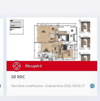

Hi, I dont know what happened but I worked all day on my layout file and it didn’t save once in the day, and I usally save a lot, and now the recuperate version dosen’t open as well but I dont have any error message it just turn and turn without nothing. The 3D file didn’t open to but I manage to recuperate it. Can I get the recuperate layout file elsewhere?

I cannot open it and the last saved on the file on my computer was on dec 5 and i’m afraid to open it and loose the recuperate file of yesterday. I’m using 2025

It’s actullay my dec 5 version not the recuperate file of yesterday that I could not open…. I’m still going to have to redo everything I did yesterday :pensive_face:
I thought you had shared the recovery file. It should be in User/AppData/Local/SketchUp/SketchUp 2025/LayOut/Working
No I didn’t know where to find it. I dont have sketchup in app data/local
