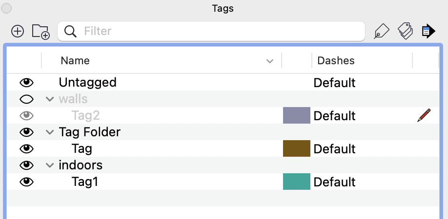

Trying to create an extension 'Tag Folder Visibility' to hide and show specific tag folders

I don’t think you can hide any folder that is a parent of the current tag. You’d get the “You can not hide the current tag” warning, or, I guess, the current tag would be reset to the default (layer 0). I think you could hide any sibling of the parent, any children of those, and any sibling and their children in the active path, or any children of the active layer.

If you try to hide the parent folder of the active layer, e.g::
Sketchup.active_model.layers["Tag"].folder.visible = false
It will return false, but silently fail to set visibility to false.
But maybe that’s not only due to running ruby.
I can actually hide the folder of the active tag in the UI. Select a tag in a hidden folder, which unhides the parent folder. Then undo once, and the folder gets hidden again.
I don’t know. My brain is still looping on why I’d want to move the pencil from Untagged to make anything else the active layer.
