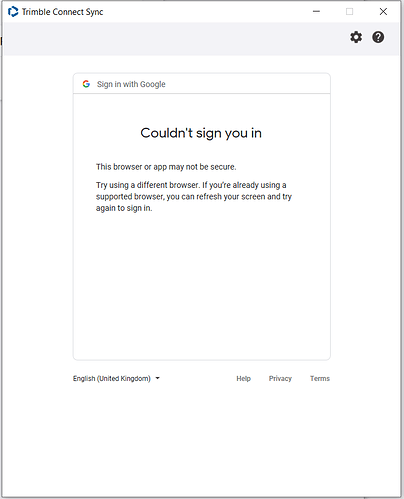

As I’m designing a multi story building I thought I would try Trimble Connect to see if I can make use of any X-ref type features and got myself in a confused muddle.
For a start, the Windows app won’t let me log in using a google account…

Your old Google sign in might have taken it’s own Trimble ID. The security rules for Trimble Connect are different, so the password that you use for Google sign in might not work. It might have worked in the past ('All things SketchUp, 3D Warehouse)
You can use the yellow Trimble ‘sign in’, fill in the google mail, but then do the ‘Forgot Password’ procedure and reset the ‘Trimble’ password. Once set, you should could use the Google sign in again.
