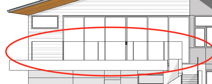

But this is how it appears in LO:
As you can see, the shadows (and cladding material of the wall) appear to peek through but the other lines of the sliding door panels behind do not show…

I am fairly sure that what you are seeing is not a problem, but is just how things work. To get transparency you need to render in Raster, if you use Vector, faces will be filled in. For the model that looks wrong, you’re using Hybrid, and the Vector part of that is causing the faces to be opaque. The model that looks right is set to Raster.
You could go into your model and delete the face, rather than rely on filling it with a transparent material. Then Vector or Hybrid will look correct. Finding your way to the face is a small challenge, given that it’s see-through. You could set Face Style to Monochrome, to speed up finding the right face.
