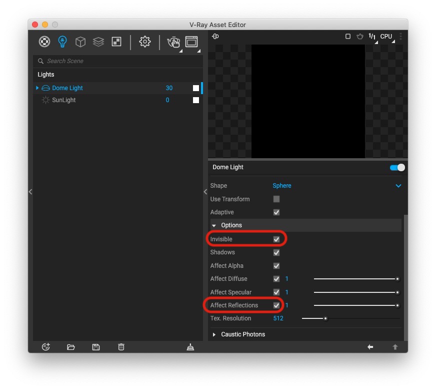

What was the advantage of using the Dome Light vs the default sun and sky for such a simple model set up? Also, have you looked at setting the dome light to invisible? Or uncheck ‘affect reflections’ as well as it looks to be a metallic surface.
